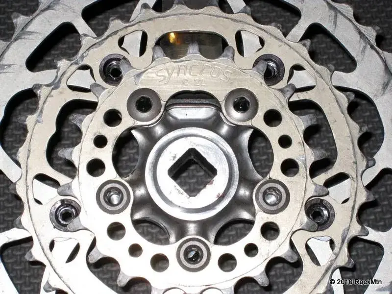

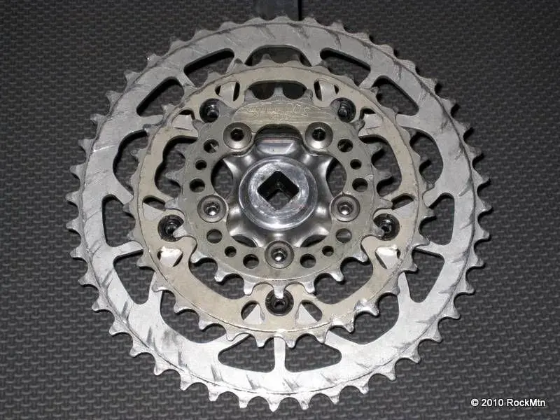

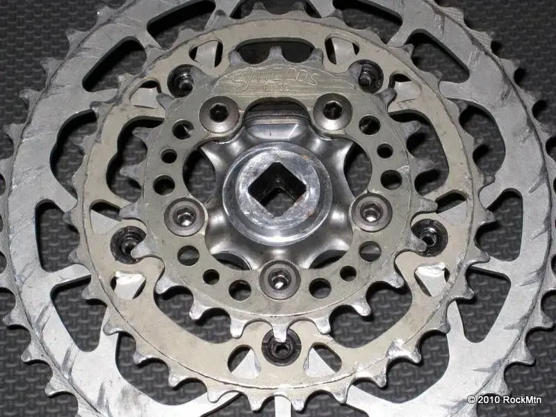

Just swapped in a set of Syncros chainrings and the chain seems to be hopping off the middle ring under load. I'm guessing it's too badly worn to be used, but it doesn't look THAT bad.
Should I keep the inner and outer and just change the middle? Or revert to a full set of new Race Face rings as they are all just too worn? This is with a set of Syncros forged cranks. :cry:

They look badly worn to me. Look at the middle ring in the bottom pic at 11 o'clock position.
The big ring inner also looks a tad chewed too. Chain falling off a ring often means wear on the ramps. The chain ring is then toast.

You are bound to get chain jump with a brand new chain on old rings.
Your choice is wait for chain to wear a bit, or replace rings. If changing the rings, I'd keep the outer and just change the middle and inner and see how that works.
I think a little bit of chain wear is ok. Maybe get yourself a chain wear indicator and at least then you won't need to worry about it getting worn to the extent of killing the cassette.
