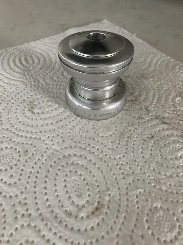

I’ve got a campy chorus one.

They're BC-1's but I think a previous owner has mixed cups and associated bearings from a threaded headset with a rogue top cap which doesn't fit, hence looking for a new one
I dont think shimano ever ventured into ahead - rumour had it at the time that diacompe wanted millions for the patent.
Bc-1 is stamped on some shimano headsets to indicate the thread pitch afaik, so your headset is definitely a bodge - as a rule that won't work.
I'll see if we have a used top assembly inch ahead - assuming your lower set is ok?
Go to your local engineering bearing place, the kinda of unit on an industrial estate with the existing race and they'll probably have one
If it's a shimano race (bc-1) it probably doesn't have the flat angle to take a cartridge bearing, and if it's a mix up of ahead and threaded, there's probably also a mismatch between the cup and cone.
It's also likely part of the wedge assembly is missing.
We see mismatched headsets all the time, they are truly horrible, and if one headset is missing a part, it can't usually be taken from somewhere else.
You can replace the top assembly or the bottom, or find the correct parts.
