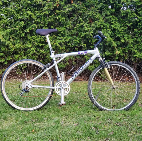

1991/1992 GT Zaskar
The RS Mag 20 could be an original as well. It was an extra cost option on '92 Zaskars.

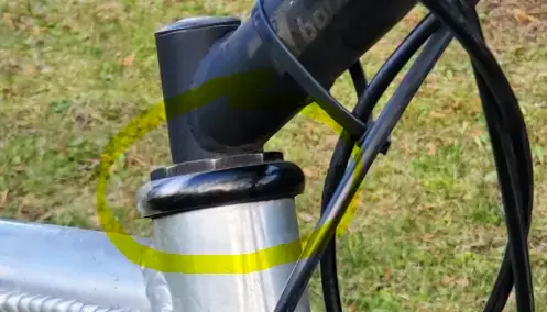

Good point! At first I though it was original for sure. However, the steerer is way too short for the headtube so it must have been installed afterwards... or the steerer was cut for some reason?
