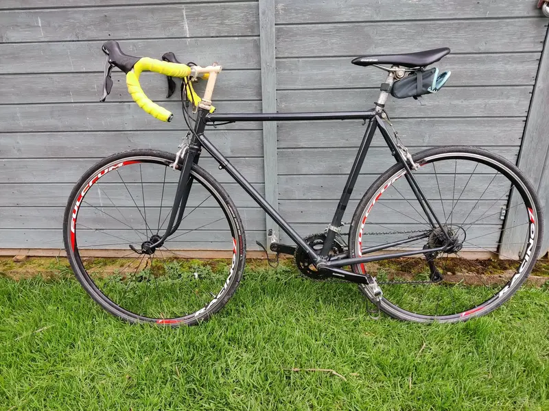

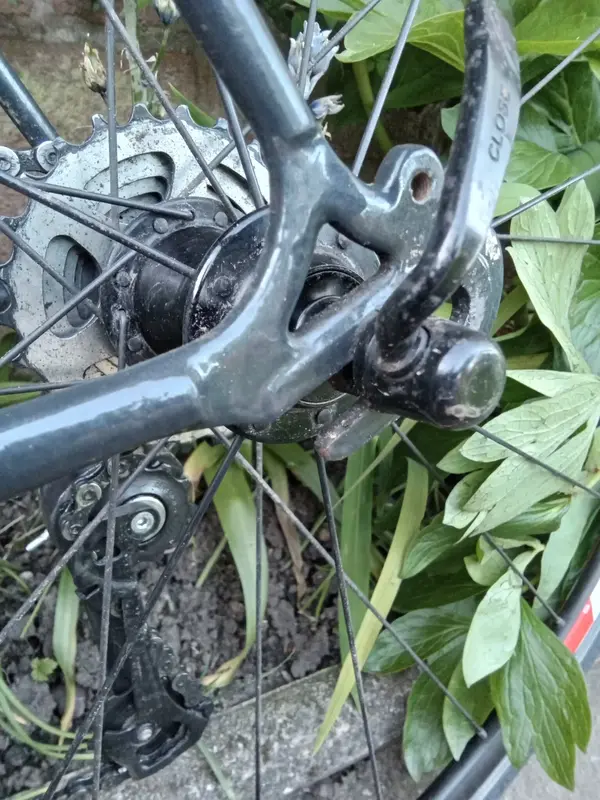

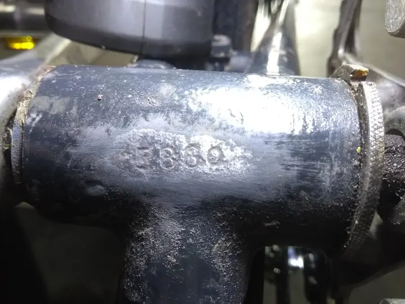

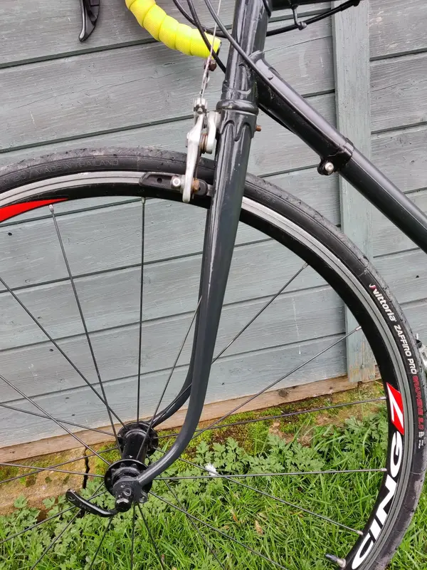

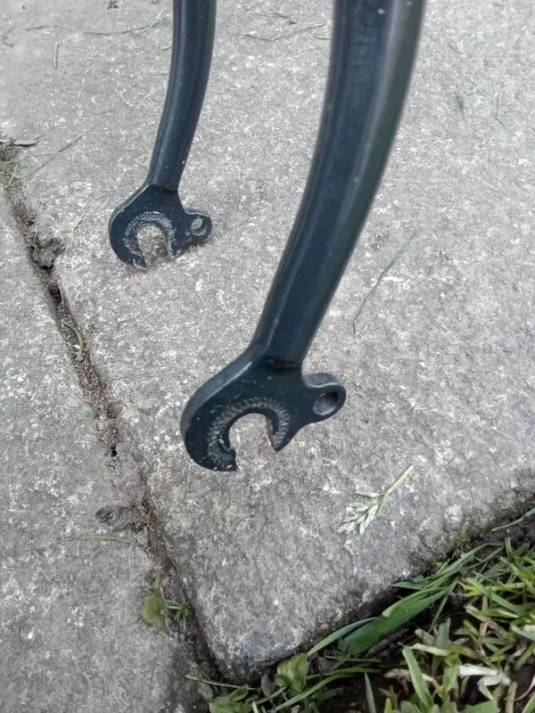

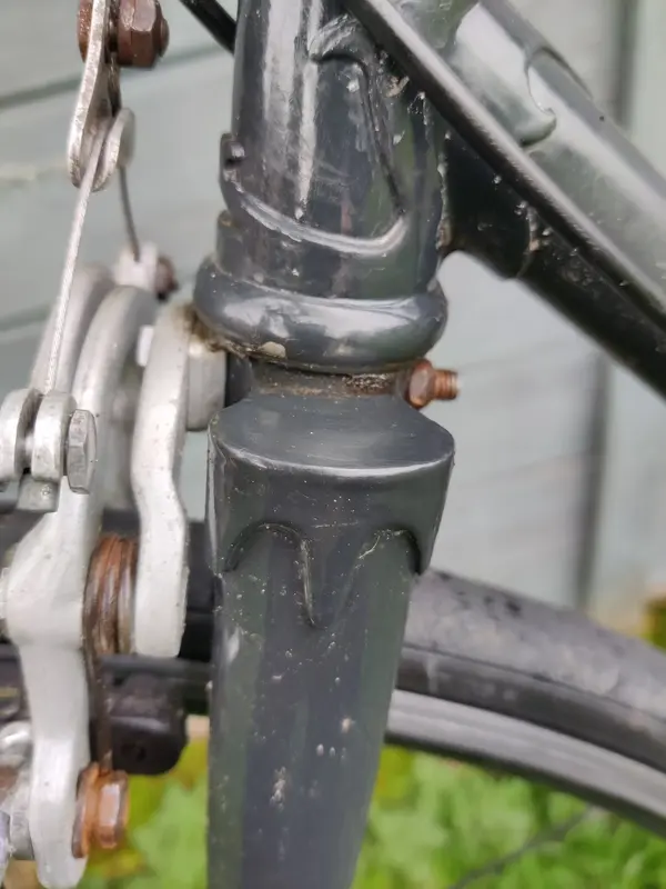

Hi, Can anyone help de-mystify this one ?? It looks to have all the hallmarks of a 1960 CB but the forks and fork crown seem odd compared to all the other images I've seen. The crown is a Legere pattern 2 as far as I can tell (flat on top unlike most the CB's) and the forks are much straighter with more rake right at the very bottom - a bit like some of the older Grubbs. Frame number is 5860 on BB and steerer. I've owned since the early seventies (now modernised but still have old parts)
Thanks
Graham
on the face of it, looks like an early Holdsworth Claud and I agree, the number points towards 1960
I first thought Challenge or Coureur but then I noticed the rear dropouts look cast not stamped?
If cast front & back perhaps an early Cordon Bleu. Over the first few years Holdsworth did muck about with bits & bats.
