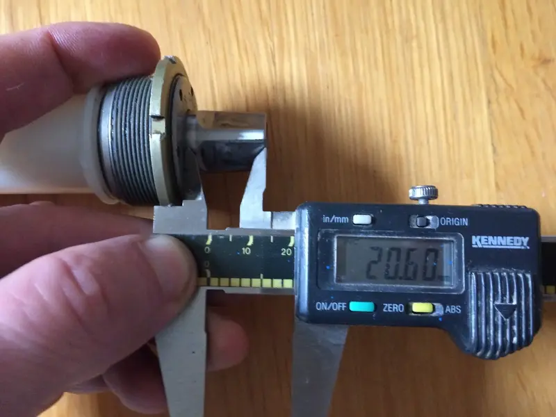

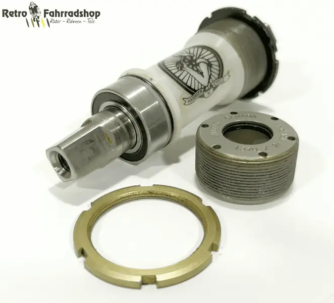

I looked at a couple of Syncros BB's.. one for sale here via Tomato which was 131mm spindle and JIS taper.. he measured the size at the end of the taper which was 12.66mm, the exact same size as the Shimano i had just removed.. so yeah JIS.

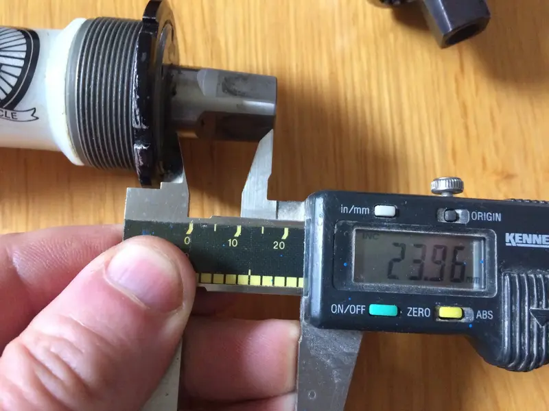

The other was advertised as JIS with 127mm spindle via ebay from this seller based in Germany, he took the same measurement at the end of the taper with his cheap digital vernier which read 12.6mm but it looked like the measurement was taken part way down the taper, so i asked him to do it again.. he took the same measurement with his non-digital vernier, locked it out and wouldn't fit the end of a Shimano spindle so i was pretty confident it was actually ISO.
When it was delivered the driveside lockring^ was seized tight (thanks for mentioning that!).. i had zero chance of removing it at home but thankfully i have a workshop at my disposal and managed to get it off without stripping the threads..I checked the size at the end of the tapers in 4x places and they vary between 12.5 and 12.57mm (it's super lightweight) :cool:

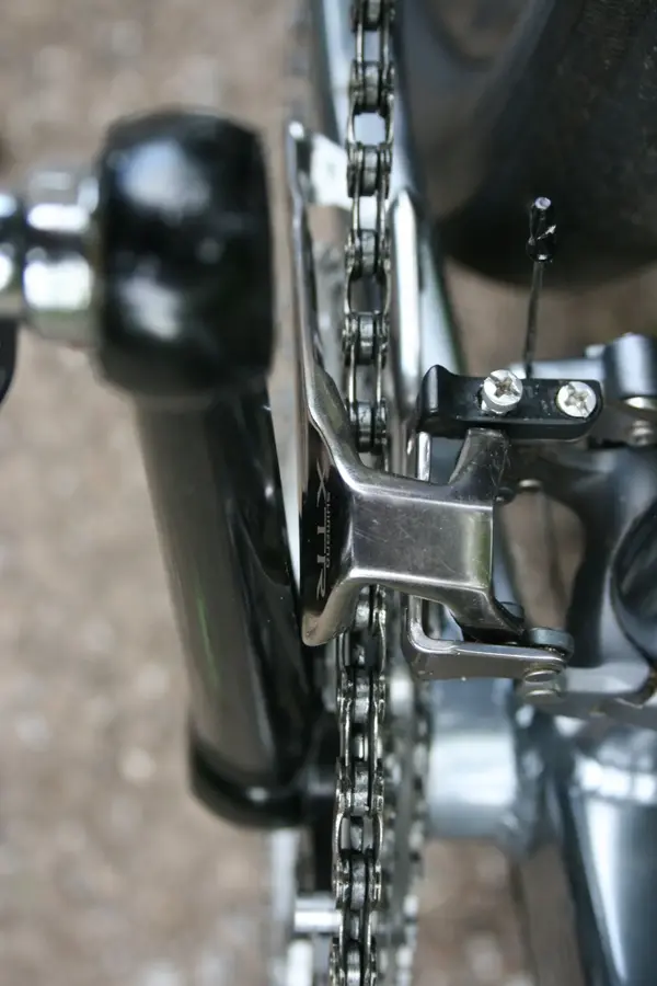

The BB can be used in either 68 or 73mm shell, I read that one could offset the Syncros thread within a 68mm shell using the extra 5mm thread giving me that extra bit of clearance i needed for the small chainring but when i measured it, the spindle is actually offset by 4mm in favour of the driveside.. perfecto!
Which puts the extra few mm's of thread on the non-driveside and because of this clever design the longer spindle flex is reduced massively

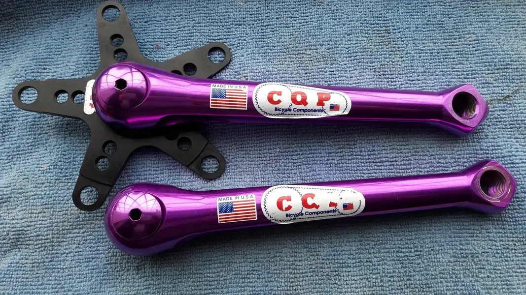

Its silky smooth but it is tight in there, after some fiddling..i set the chainline to give me 1mm clearence between the small ring and the chainstays and the high limit screw locked down to stop the front mech rubbing on the inside of the crank arm.. again, there is only about 1mm clearence with the high limit screw stopping it moving out any further.. probably explains why CBR started notching out the back of the arms..
Took it for a spin and every gear works perfectly with a small amount of chain rub on the mech in the top and bottom gear but i use that lever in friction shift so i can give it a little tweek if needed.
