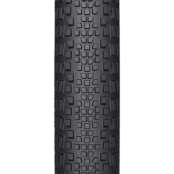

Then this week I did a few runs to work on my second Roadrat (the rain-focussed one with mudguards) and found something Interesting. The orange Rat has 45C WTB Riddlers on in - nice cheese grater pattern close knob lets down the centre of the tyre and much bigger side knobs. I can lean that pretty dramatically at speed on tarmac but it's always felt a bit squirmy - mainly because the clearances are very tight on the frame, and since I am using 23mm internal rims, the tyre balloon a little at 50-60psi. So the tyres are running a little low re pressure and getting the bike onto the side knobs actually is quite a transition, which results in a very unconfident transition from the centre tread to the side tread. Effect = dodgy handling when leaning.

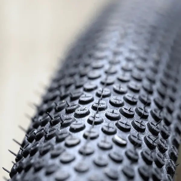

But the grey Rain-Roadrat has 19mm internal with 35C Schwalbe G-ones - which have a tiny onZa like set of round knobs. But the Good Thing is that the carcass expands at 50-60psi into a really rounded shape - and with consistent types of knobs all over the tyre, there's no weird transition to different sorts of knobs when leaning. This gives immense and consistent grip and so great confidence when really pushing the bike round a tarmac curve. They are really great-performing gravel tyres on the road. On loose gravel they are so so, and cornering or climbing on loose stuff or slop is poor compared with something like a WTB Raddler. But the G-omes are just great for summer and winter commuting on dodgy cycling paths and city streets.

For your gravel bike, if you like the G One, I can recommend the G One Bite. It’s like the one in your picture but with a chunkier side tread. Would be a best of both worlds between the two you run.

Actually I have indeed looked at the G-One Bite and will have a go. But the point I was drawing attention to in the post above is that on tarmac it's the transition onto the chunkier side knobs which instils a lack of confidence - and the common knob pattern all over the G-One carcass which allows continuous consistent grip as you go through the lean angles on the tyre which make it a very secure performer....which is interesting.
