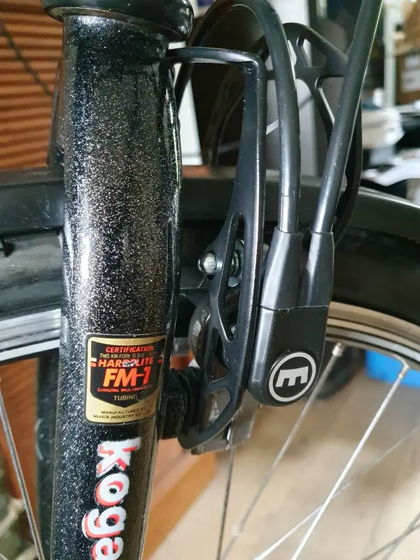

You'd need the "new" clamps as they have notches that fit in the booster.
Unlike the HS33 that uses the fork L-stop (if that makes sense)
You can do it if you insert longer screws that act as the "notch" on the newer clamps.
tldr; Yes they will work.
Found some pictures,
I had to use older clamps as they are offset. I needed more clearance on a '91 Koga.
Photo shows old clamps with longer screws and a dome bolt in a newer booster.
Hope this makes things clearer.
