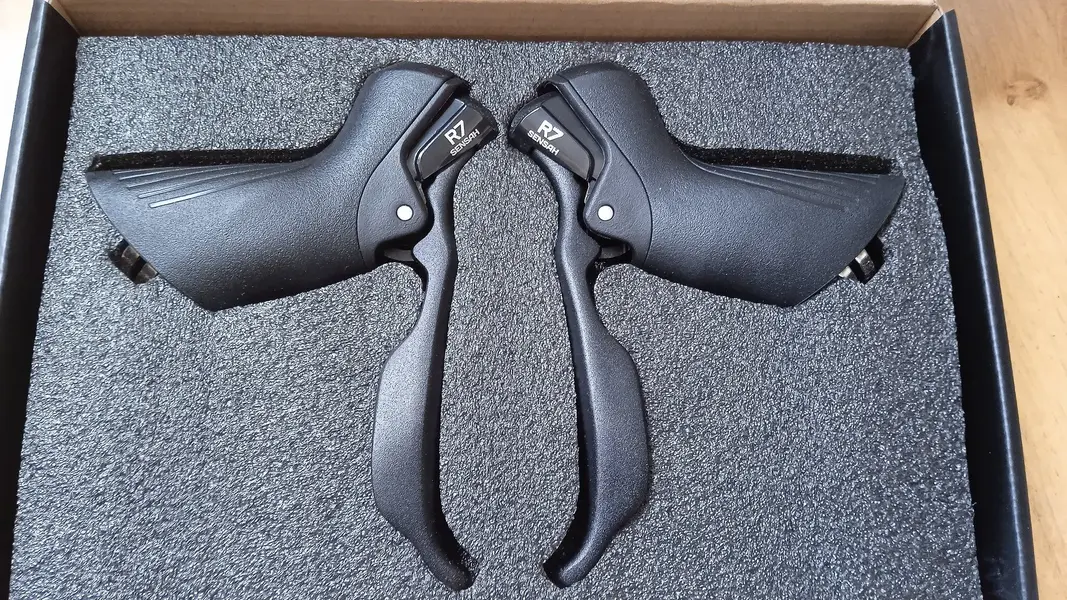

And here they are! Nicely packed, and they appear to be very nicely made. Pivots are tight, no slop. The mechanism feels good, nice positive clicks. The shape feels good in my hand (I've never used SRAM levers, which I think these are based on, and the most modern Shimano levers I have ever used were 8 speed ultegra STI. I've used campag for years, unless just plain old brake levers. Certainly nothing this modern). The hoods have a nice feel, and also have several tabs on the inside that locate into recesses in the lever body, so they will stay put. I have to fit, adjust and actually use them of course, but for less than 50 quid I am very impressed! I plan on fitting them to the Yates with it's 7 speed deore DX and cantis. Will probably take me ages to get around to it, but I will report back...

OK, so first test ride on these yesterday. The levers are larger than what I am used to, but I find them very comfy. Shifting is very good - nice action, easy to move the lever but with a positive click. The 7 speed rear DX mech indexes perfectly. Front won't drop down to the small chainring, but that is more to do with the mech adjustment than the levers. They will only shift over 2 of the 3 chainrings though. Not a major problem, I will set up for inner and middle for now, and look at swapping the middle for a 38/39/40 to give a slightly higher range. I am still getting used to the shifter action - the same lever does braking, and both up/down shifts. Seems a little wierd (I am used to campagnolo where there is one lever for each thing, not one for all 3!), but I have only had a 10 mile test ride so far. There is a faint rattle, especially from the left lever, so I will have a look and a bit of grease in the right place will probably fix that. All in all, I like them!
