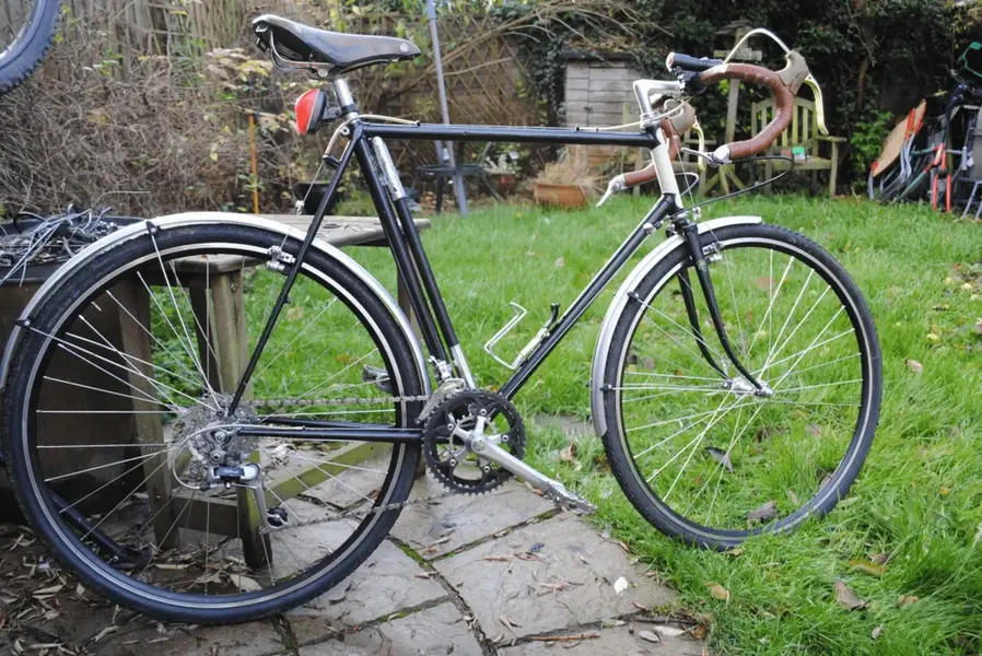

I was running standard Shimano shifting on an 8spd Campagnolo cassette ('triclour' 600)

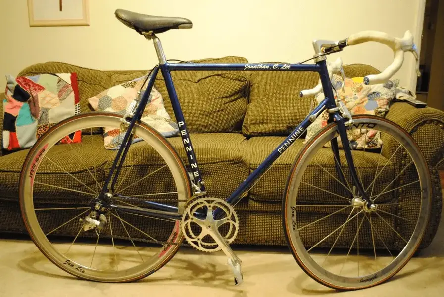

My Pennine runing 8spd 600/ Campagnolo (Jon C Lee being the former owner and also know as 'Pickle')
