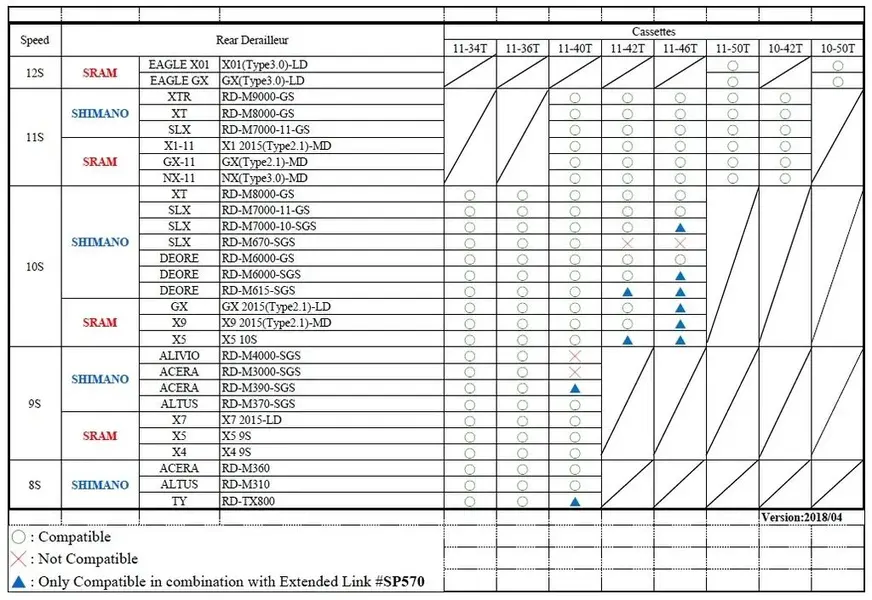

For bigger ones you either have to use a roadlink adapater, but i wouldn't recommend this as it isn't operating precisely then the smaller sprockets, or simply a rather new rear mech (which than also has daming to effectly avoid chainsucks). Usually the list below is giving a bit of help which combinations work.
Also for SRAM X9 type2.1 and to have positive experience with 11-40 in a 9 speed set-up.

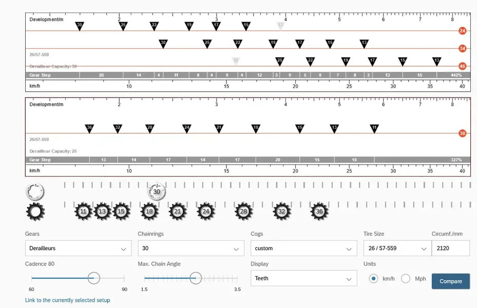

Usually i do recommend to use a calculater like Ritzelrechner
http://www.ritzelrechner.de/?GR=DER...RZ2=11,13,15,17,19,21,24,28,32,36,42&UF2=1900and to compare a proven set-up with a planned one upfront, just to see differences.
The screenshot below is comparing a 3x7, 24,36,46 / 13-30 with a 30T chainring / 11-36 at a cadence of 80 for a 26" bike.
As you see, distribution of speeds works good for lower speeds, but the higher range is pretty limited.

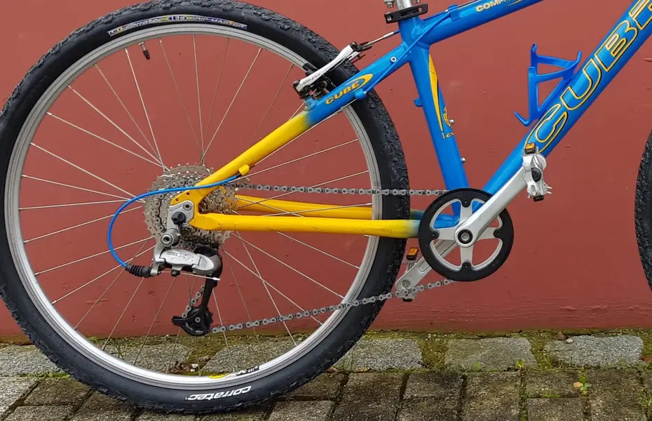

Cube with Islabikes 150mm 32T cranks and XT750 with 9 speed 11-36

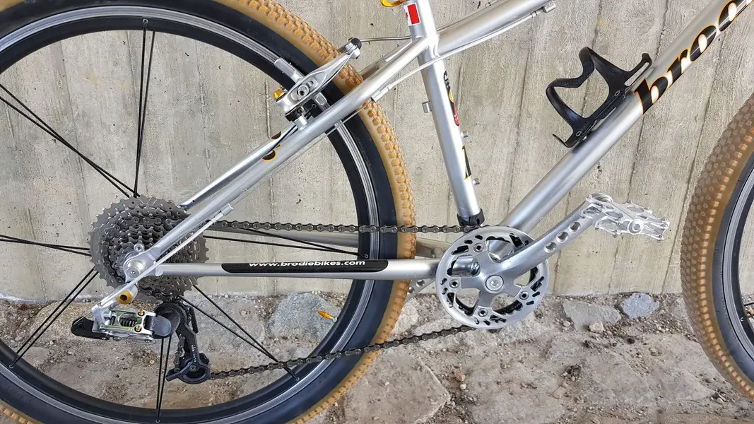

Brodie with shortened Sugino, with 34T chainring and X9, 9 speed 11-36
