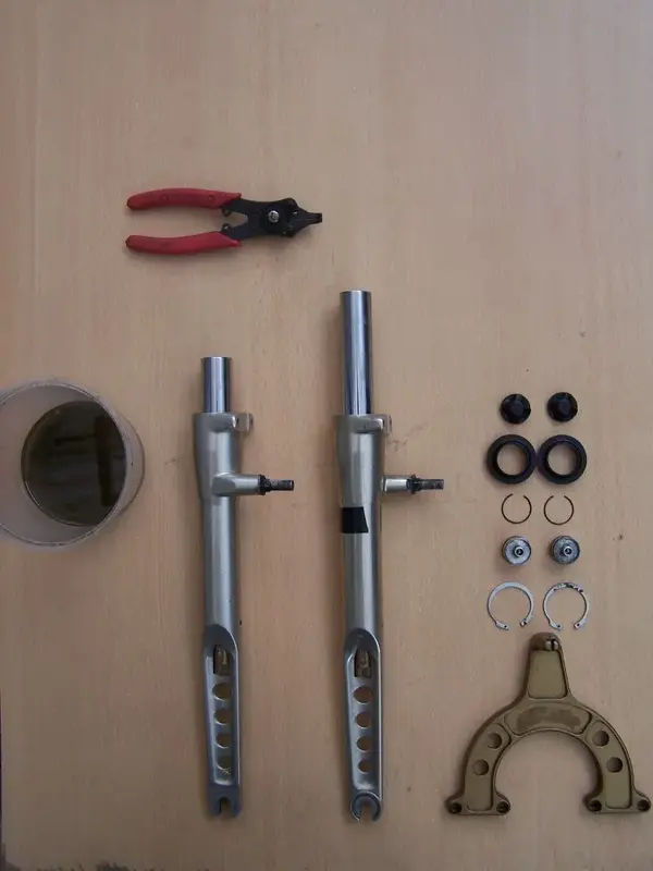

Seemed a great idea at the time but having carefully begun the disassembly, I'm stuck (well stanchions or tubes are).
Attached are the pics of the various circlips etc already removed. I have removed one of the grub screws at the base of the stanchion but this seems to make no difference to removal.
I have taken the forks to most of my LBSs and motorbike shops without success.
Started this as I liked the lightness and smooth nature of the forks but they had started to loose air pressure after a short ride, there was no oil leakage.
Any ideas, Please.

My problem seems to be none of the LBSs have the Marzocchi tool 17 (Stanchion support plug) to prevent ovalising the stanchion when placing the fork tube in the vice.
Are there any alternative methods to the use of a protective vice & insert to pull the stanchion from the tube?
Thanks
I seem to remember the stanchions coming out by hand - with a firm tug - I assume you've tried this? Else, can you shape some blocks of wood or tough rubber to protect them while in the vice?

use the crown and/or top cap for the stanchion holder.
If you cannot tug it out, then put a bit of oil in, secure the top cap in again and pump it up.
that should separate them. just remember oil may spurt out.
