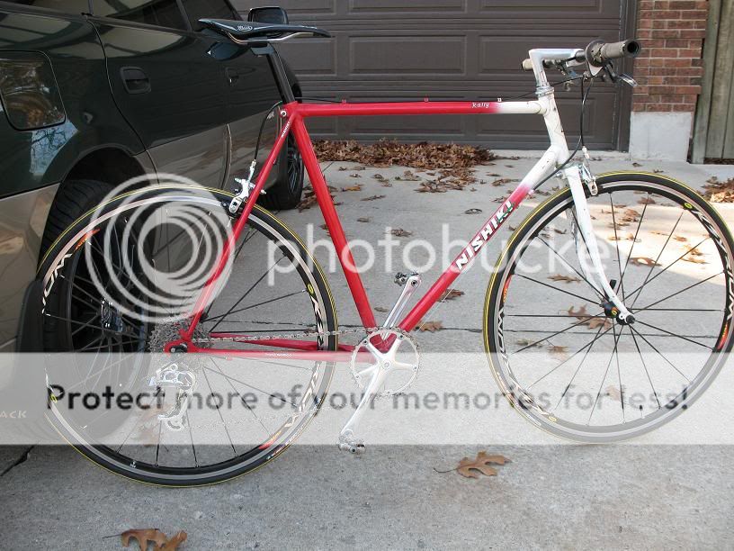

Step on: I found this old beater (another buddy handed it over after hearing what I was up to (thanks JAMES!!)) and found it was in good shape after looking past all the crud and shitty parts. A good solid, non-coroded steel beast of a Nishiki. Still straight too!!

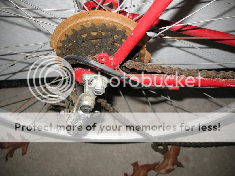

Old bits needed to come off....

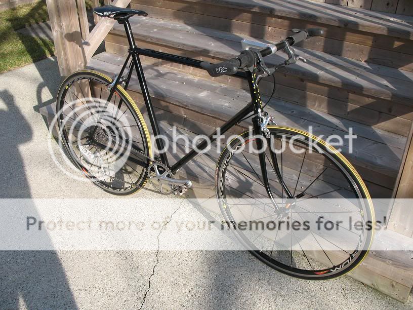

So, after the mockup and test rides, I tore it all down again and spent quite a bit of time stripping the paint off for the final leg of the project, and my of my vision. I prepped, primed and painted the frame completely black.
It was then that I purchased some yellow paint markers to write all the names, or messages of those who sponsor me for the ride. I thought it would be a great way for my sponsors to show their support and a great way to attract attention for the cause and so far it's working well.

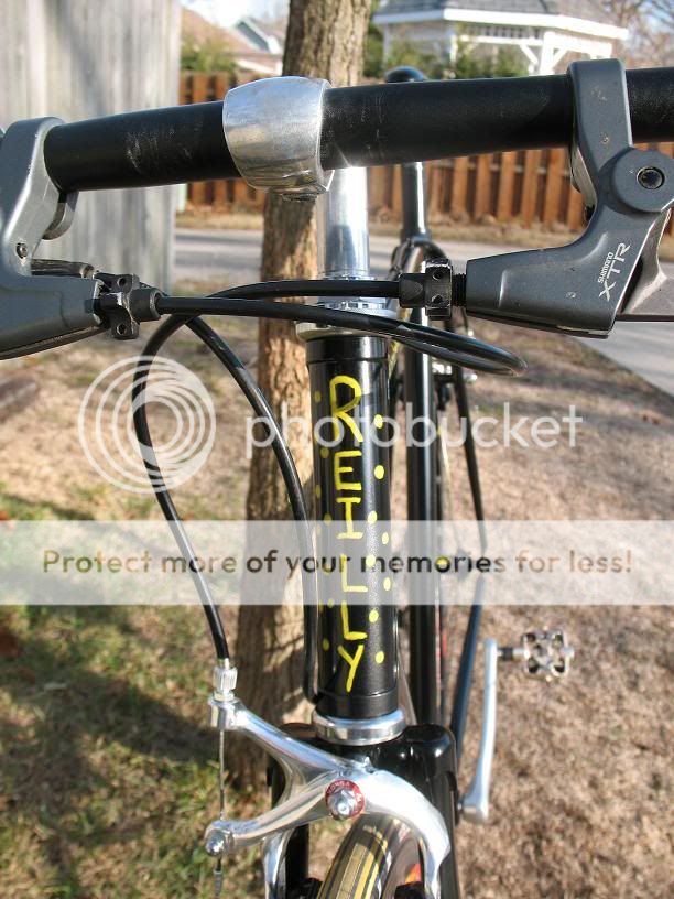

Of course Reilly's name adorns the steertube.
