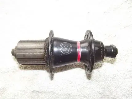

Selling the above on behalf of a friend. Rim split on the wheel this was on, he assures me it is in good working order, bearings and freehub seem fine to me. No idea about this newer stuff :oops: so is £15 posted reasonable?

Sorry mate, as I said above I haven't got a clue, anything later than Shimano 8 speed is lost on me! all I know is that it's marked DT swiss race lite and came out of a bontrager 9 speed wheel on my mate's Trek, someone else on here may know
This is hub is basically a dt swiss onyx/cerit hub - uses pawls not the ratchet of the dt240 (which used to be on bontrager rxl wheels) An easy visual id is that on the dt240s the end caps just pull off, rather than be held in by nuts. These hubs were used on bontrager rl wheels. Used them for years - dead reliable- the service kit of 2 new pawls and retaining spring and grease is still available at £6.99 on crc. Wheel uses sealed bearings - there is even one in the freewheel body.
