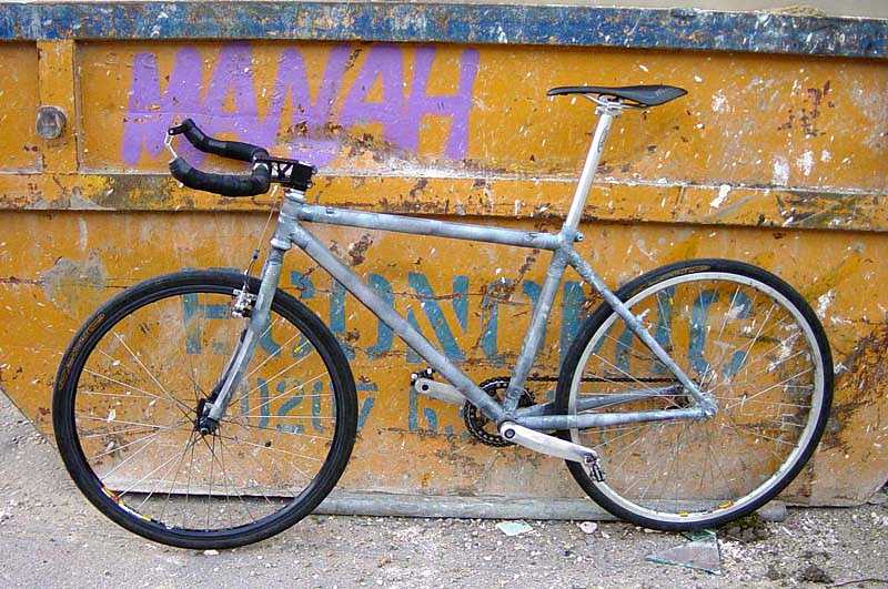

This is the point where I really wish fotopic was still working... my commuter is an Orange C-16R with slick tyres (Conti Sport Contacts, the choice of couriers), bullhorn bars and fixed wheel (42x14 on a 15" frame, incidentally). It sounds like a complete dog but it's actually a brilliant ride!
: P
Found an old pic on fixedgeargallery, when it was covered in gaffer tape and reflective cloth stuff (and had really crap bar tape!) - it's now got a Chris King headset and I stripped all the cack off and re-coated it with ambulance tape, although most of the time it's coated with a thick layer of road gunk, but I keep the moving parts working.
