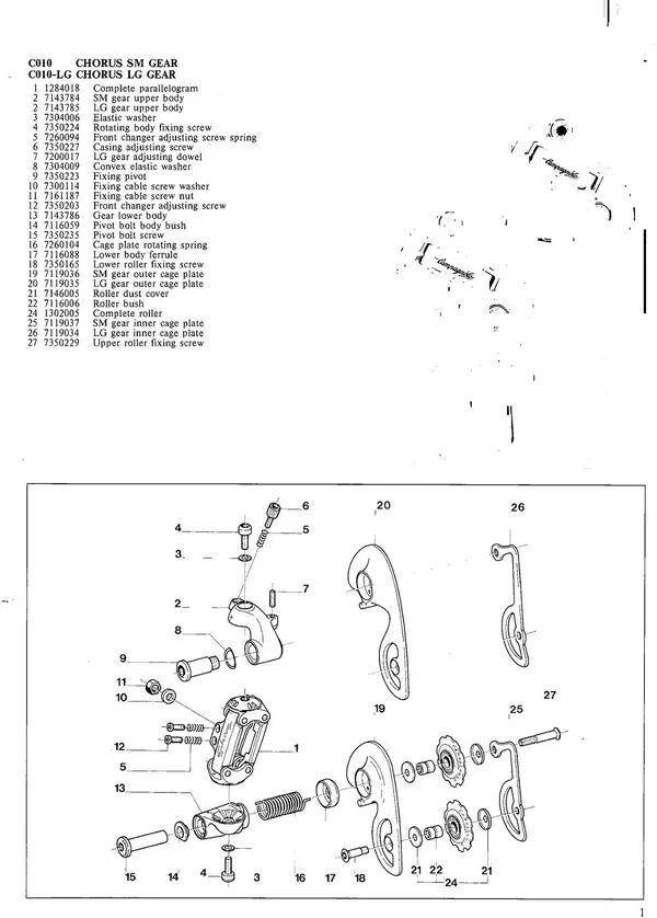

I've just got hold of one of these (as seen in the pic below from velobase), and need an exploded diagram, tech sheet, instructions, or whatever documentation I can get hold of please!

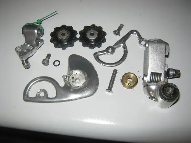

The problem I have is that when I got mine, the cage was slightly loose on the main body, and I took it off to have a look :D I've tried putting it back together, but Im having trouble getting the bolt to engage in the threads on the cage plate...
So I want to check that I have all the right pieces and that I'm doing it correctly before I put it back together again! I also need at least one new jockey and screw, and preferably both (but those are easier to fix!)

well on closer inspection of my mech, it appears that the threads in the back plate where the lower pulley screw should go aren't there. They've probably been stripped out at some point :evil:
So I need a new lower pulley wheel, and a suitable nut and bolt to hold it in!
can anyone help?
