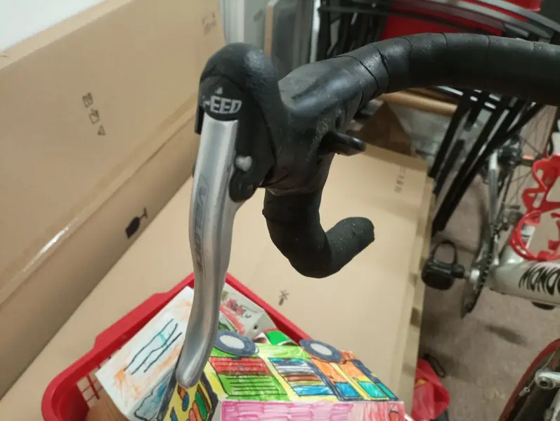

I have picked up a bike with Veloce 9 speed
Now bear in mind I'm used to shimano.
The shifting is terrible, the worst is down shift, you have to tap the thumb paddle with just the right amount of pressure, and the right amount of pressure is different for each gear or it does multiple downshifts.
Its best to stab at it with force but dont go too far
Upshift takes way more pressure than shimano.
I rinsed the insides with wd40 and lubed the cable and it improved it slightly.
Is the shifter toast?

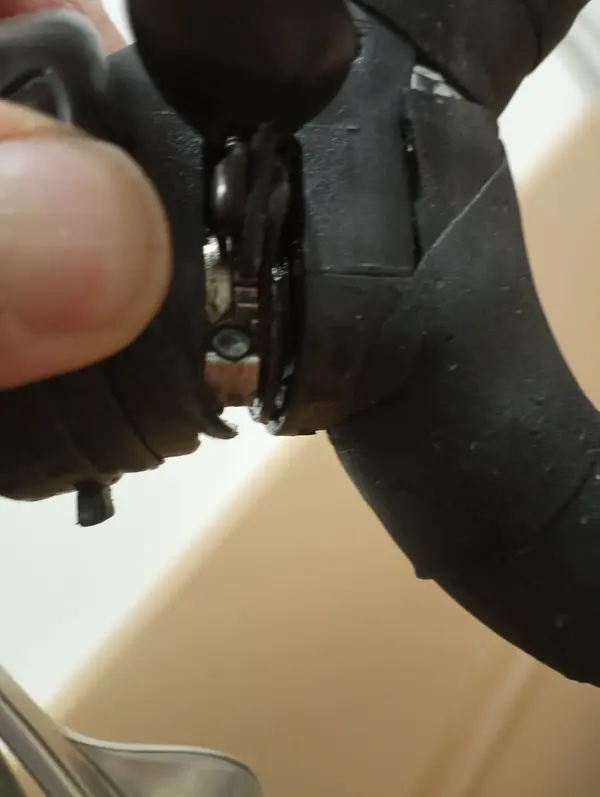

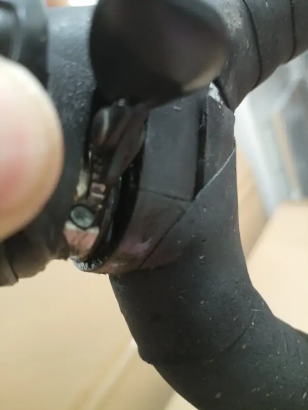

I will try a new cable. When I had the hood back I was surprised to see the plastic thumb paddle directly pushed the metal toothed ring around! surely not great having plastic on metal(!)
Campag shifters are very rebuildable, so the shifter is very rarely toast.
FIrst point of call is cables. Campag runs with slightly thinner gear cables (IIRC 1.5mm instead of 1.6), so if somebody has run Shimano inners through Campag outers it's going to be sticky.
It also might have a snapped G-spring. They will work with one spring (in a get-you-home kind of way) but indeed it gets tetchy. Springs are £5 or so fron Sigma Sports.
What shifters are they? Pointy top, pre-2001 round top, post-01 round top?
That's not right. The paddle attaches to a metal pawl arrangement. What generation shifters are they? The latest Veloce have plastic innards but IIRC the ratchet ring is plastic too.
The last generation of round top have cruddy insides and are distinguishable by the upshift paddle poking through a hole in the rubber hood instead of a slot. Chorus & Record keep the old type insides.
Here you go. See plastic lever acting on the metal toothed ring!

Yep that is normal looking
From my experience the hoods and general condition look like they need servicing I.e. New g spring. This is enough educated guess based on the visual condition. Obviously ymmv.

Its a worn ratchet mechanism that you cant buy without replacing the whole lever body complete.
Ive had it on my 10 speed for years and I found that a slight amount of pressure on the upshift lever as you downshift stops the overshifting downwards. By applying a little pressure on the upshift lever it helps seat the ratchet mechanism.
