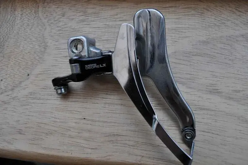

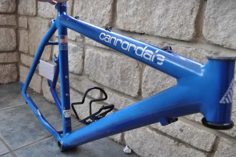

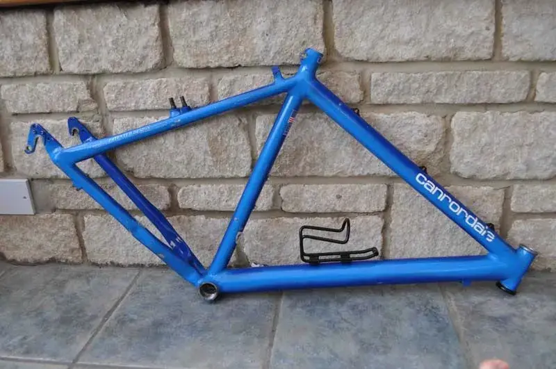

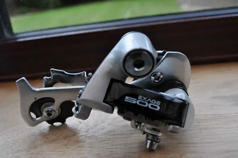

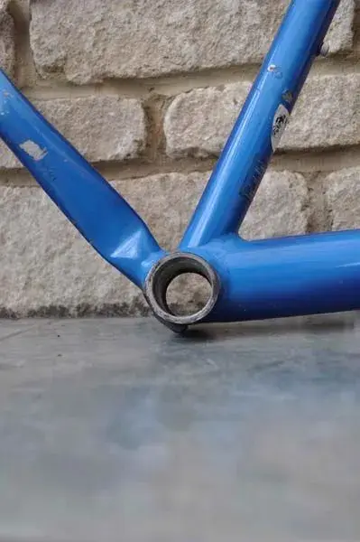

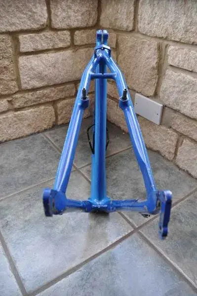

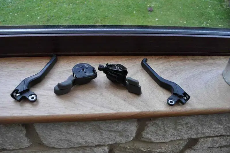

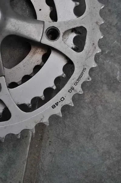

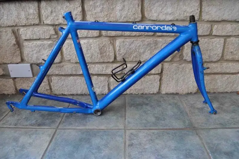

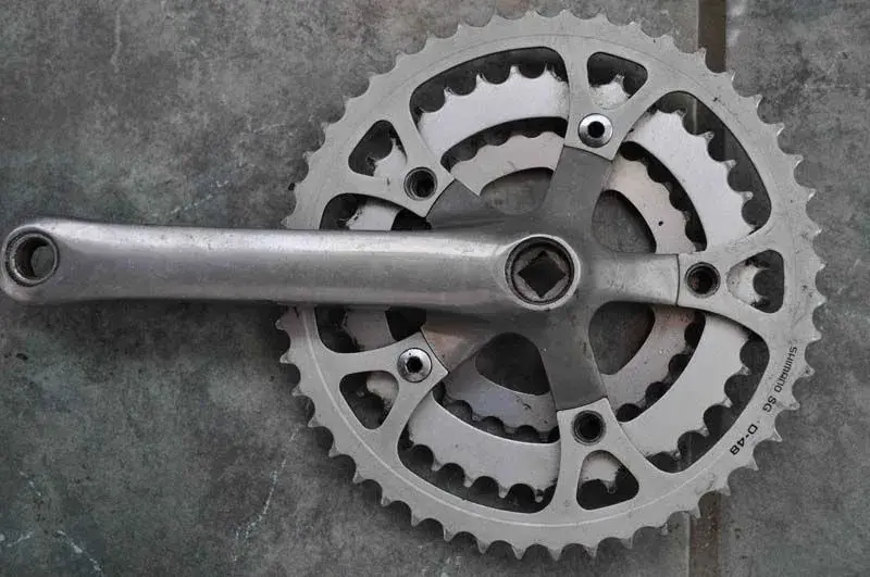

Hi guys, thanks for the reply's. I've taken some pictures of the frame and of the original parts that i've taken off the bike, I woud like to restore with the orignal parts, I"m having some trouble with the rear de-railer the top cog doesn't spin freely and is tough to turn after cleaning. I think the bike is an 89 not an 1992 like my dad thought, i've checked the serial on the bottom of the frame. Have a look at the pictures and any advice would be great! I've taken one with the orignal forks in place, but as you can see the Headset and down pipe of fork has been cut off. What size forks would i need?

1989 build date, 1990 model year, 1in headset. Parts look in OK shape, although those shifters were never much cop :)
Yeah the shifters feel really stiff so I will probably replace them, will i need to find a set of Shimano 7 speed shifters?
