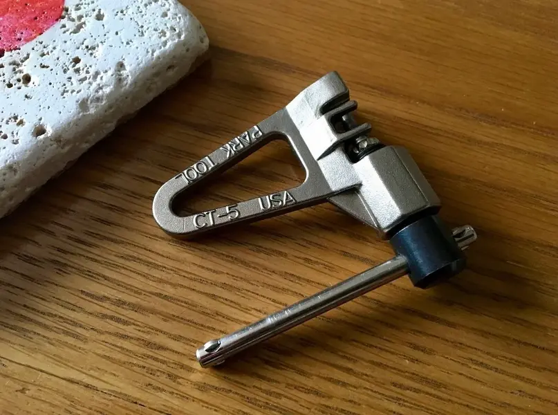

I use the Park CT-5 mini chain tool (costs £10), never had a problem in using it on all kinds of 3/32 chains. Sometimes it’s worth spending a bit more.
+1 for the CT-5
has been perfect on 8, 9, 10 and 11 speed chains 8)
