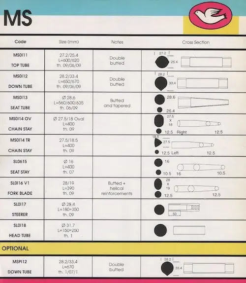

Columbus MS...a truly awesome "multishape Gilco design" tubeset from Columbus in 85/86. Nothing like it before or since.
Cromor steel, same as SL SLX etc, but the shaping was apparently the product of some of the first live stress testing of frames.
Good blog page from Anvil Bikes here.
Dedicated lugset, triangular LH chainstay. weird fat but ridged section main tubing, tapered seat tube....

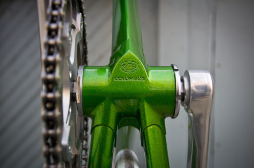

Blackbike - plenty of work to do first in getting the frame polished and the BB shell re-painted. Not quite ready to be shown in public. No doubt a build thread will appear in the readers bike section at some point ;)
Danson - the tubing is out there in terms of shapes and construction - particularly impressed by the Columbus BB shell.

The green BB image is very smart - liking that colour a lot!
Referencing the tubing chart, and this is probably a dumb question but i'll plough on regardless, the seat tube: is the tube extruded to each frame size (or should I say total seat tube length) or is it a case of cutting sections to length that or as close as damn it to the chart?
Huge amount of effort if every tube was custom for a particular frame size.
