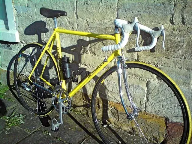

My Olagnero is Thron, very nice indeed, not a springy as SL but a comfortable and stable ride. A bit like 531 but lighter I think.

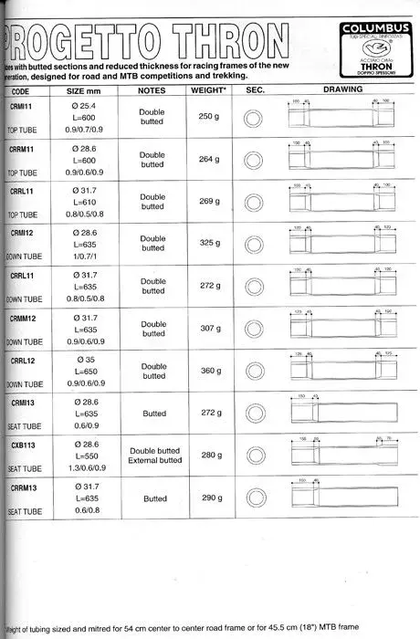

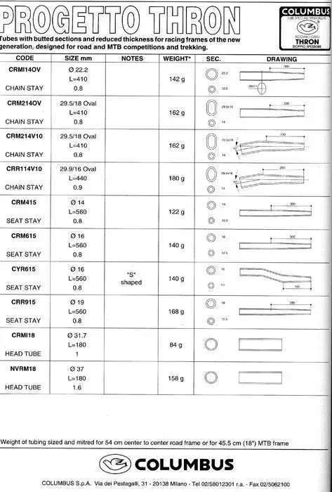

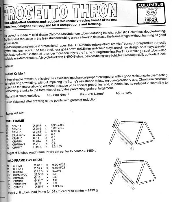

Details of Thron tubing from a Columbus brochure probably mid 90's. sits above Gara and Aelle but below Brain, Cyber, SLX, Neuron, Max, Genius. Average weight compared to others.
