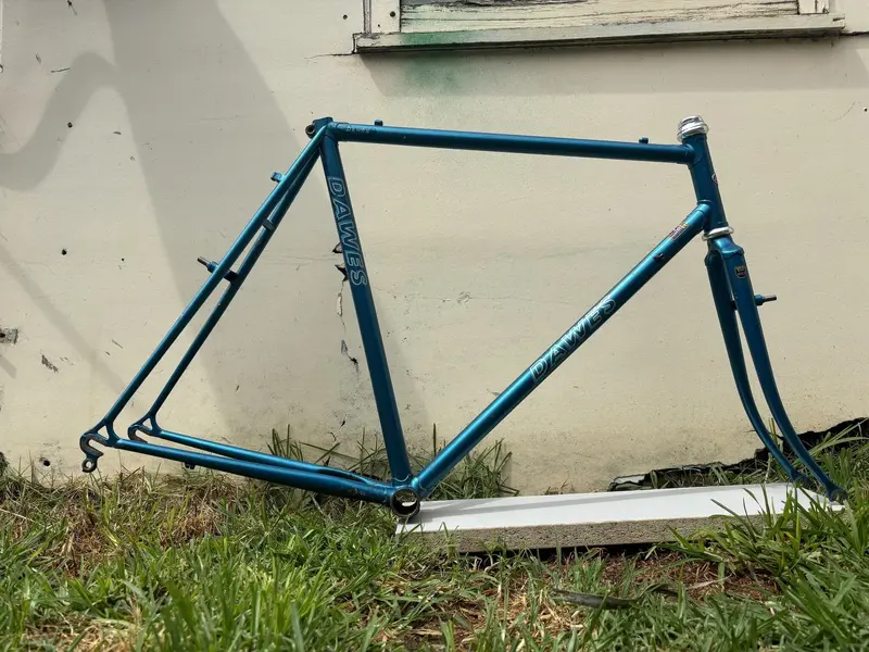

I have a DAWES frame that I have long been intrigued about its heritage, I have trawled the internet to find out what model it is and have found nothing substantial so am hoping your greater knowledge may be able to help.
In my 20's despite being in Australia I developed a fondness for old British made bicycles, I have a Hetchins Scorpion Bonum and a Mercian path racer also. I had this frame shipped from the UK in approximately 2016 (it was obviously second hand at that time), regretfully in 2019 I sold it to purchase a Ti frame, I never really rode that Ti bike and a month ago I sold it. I never really forgot about my old Dawes so spent an astonishingly long amount of time going through all my old messages from various buying/selling accounts and found the person who I sold it to, incredibly they still had it and were happy to sell it back to me, I received it back about three days ago!

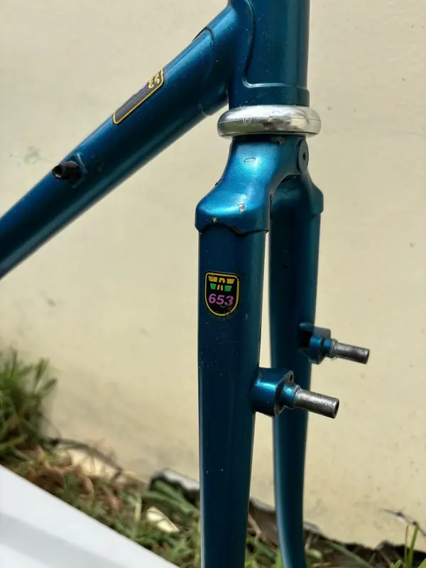

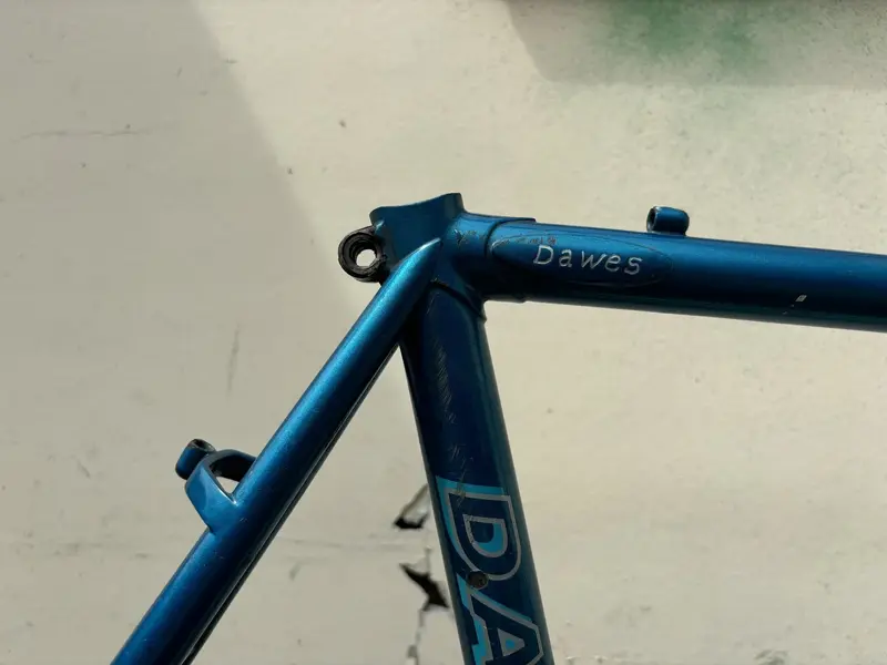

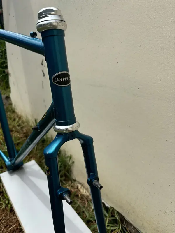

The few things that are particularly unique about this frame comparative to other Dawes are the brazed Dawes badge on the top tube near the seat tube cluster, the complete absence of any braze-ons for rack/mudguard mounting and the undrilled fork crown and seat stay bridges. It is very clearly a purpose made frame, it has a fair few dings and scratches now but it is clear this is how the frame was made and not a modified frame, the blue paint in the sun is spectacular.

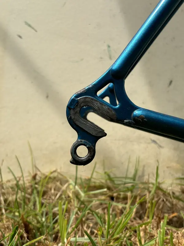

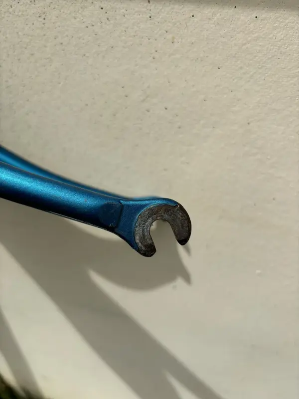

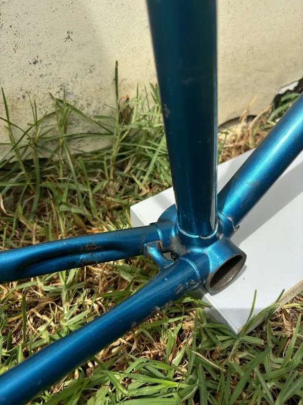

A few other things that may aid in identification, the dropouts are Gipiemme, the BB shell is stamped closest to non-drive side chain stay: 94014916 and closest to down tube: 273LH72. If anyone can provide ANY information at all, I would be ever so grateful.

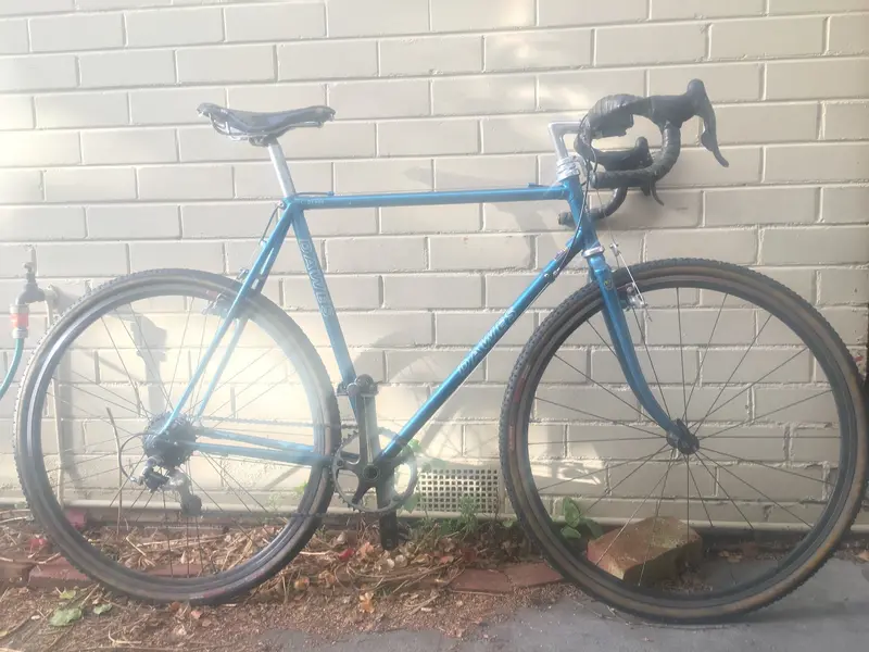

The last image is an old picture of how I had it built a few years back with Campy record 10 speed, Paul Comp neo-retro cantis and of course a black Brooks swift. I've just turned 40 so I think the new build will be less race like with some upright bars and an old Shimano XT M730 groupset.

lug pattern appears to be BOCAMA Professionnelle Luxe
this pattern offered with or without cutouts and with or without a reinforcing lip on the edge adjacent to the headtube
given its apparent application it is somewhat odd that it was constructed without eyelets on the frame ends
Thank you for the information regarding the lugs. I would think that given that it doesn't have eyelets on the frame ends is actually suggestive of its apparent application?
The Dawes badge on the top tube is a repurposed seatstay cap - obviously because they chose a different seat cluster design they couldn't fit it in the usual place. A nice detail that.
You can just see one on my Edge XT 653, not a great pic as the gear cable outer passes over it!
The script is the same, so yours is a similar age, 1994-96 was the sort of time they used it.

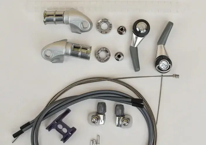

Gear lever bosses are a surprise. Cross always used bar controls, so cable stops would be more typical

I thought the same around 653 dating it to that period, except I can't find the frame / bike in any of the catalogues
https://www.retrobike.co.uk/threads/dawes-edge-xt-purists-look-away-it-has-drops.465985/
Thank you, this is great information. The first time i've managed to see another Dawes with that top tube badge and fascinating that it is a repurposed seatstay cap, I hadn't even considered that.

Thank you for having a look, I also have downloaded all of the catalogues on here and gone right through them without finding anything conclusive. Considering the size of Dawes and the breadth of communal knowledge associated with them and the fact I can't seem to find another example of this frame I am beginning to become convinced it is some kind of custom one off for perhaps a racing team or a wealthy client presuming they did even did either if those things.
