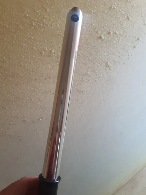

Funny enough I have polished a USE seatpost this week.
This is what we started with.
I used oven cleaner to remove the anodising. Soaked for about 20 minutes. Then it's onto the wet and dry working through the various grades. Final job is polishing, I use autosol.
And this is what we have now. I might go over it once more to be fair and run it over the bench polisher.
