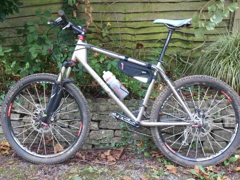

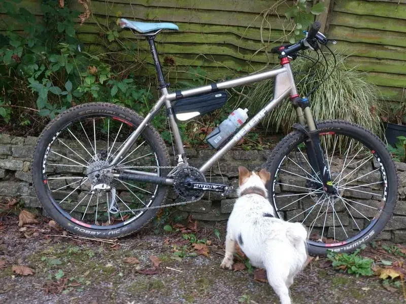

I have a 2002 DeKerf Implant which I bought to replace a Yates I had that was just a bit too stiff at the back (phnar).
I built the Implant up with some Pace forks and a decent 3 x 9 set up. I rides well, but it's too heavy, so I was going to sell it, but I've since had a change of heart and I'm now planning a winter refit, changing the 3 x 9 to 1 or 2 x 10, putting smaller disc rotors on, slimming down the other components and finding some lighter suspension forks.
I have no idea what travel the Implant is designed for, as it's 2002 I guess around 80mm.
So, suggestions for a suitable fork that is available and won't break the bank.
I thought the Team SL of the time was designed for a 100mm fork and that the Implant was the tougher longer fork model. Current Team SST is still corrected for 100mm and current Implants are 120mm.
OK, that sounds good; so what 100mm forks would anyone recommend, or has THM got it in one.
As James mentioned...I thought they were designed for 120mm forks. I would look out for Magura Durin SL's (but they may break the bank unless you get lucky)
What Pace forks were they? I thought they would have been pretty light anyway?
Maybe look for some RS Sid forks? Known for being light.
Early Implants were based around 100mm forks and later are 130mm. I'm not quite sure when the change happened,but you could check early Dekerf websites via the WaybackMachine.
I run 100mm forks on mine which are perfect for Surrey. I did run 130mm forks originally but climbing suffered. Certainly 100mm feels enough for my needs, and still gives a 13" BB height.
Don't faff around with Sids or other spindly light forks; get something reasonably Butch. Revelations or Pikes, Magura Menja , Laurin, Durin or Thor would be ideal and still only 1600-1700g. You don't want the front end giving up before the rear gets a chance to do it's stuff...
DT Swiss EXM, XMM, XMC would also be ideal.
Great advice, thank you.
In it's previous incarnation it weighed 12.9kg, so I'm looking to lose at least a kilo, as once stripped, the frame really isn't that heavy.
I shall start fork hunting.
EDIT: I just looked up the 2002 Implant, and it's built for 100mm forks.
