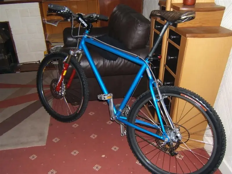

Joshua,here is a picture of the set up,the torque arm can be shortened to fit the canti boss,it may need a bit of tweaking to fit your bike exactly but I ran it for a good number of years with zero problems,there is a review of this kit on bikeradar if you type

I've seen a few boss failures using the brake therapy style mounts. The bosses arent designed for the stress of being pushed upwards. The fact you can mount them elsewhere is good, looks nice on the frame above.
Thanks ishaw,it was a very good system ,I have heard of failures of bosses ,The longer arm does allow a selection of mounting points.
Non of the retro fit solutions are ideal but if ,like me,you own a very nice frame that you want to keep ,the therapy unit allows the disc upgrade,which is very significant compared to even the best canti brakes. I used Hope X2s and the difference was incredible.
It also allows the owner to go back to cantis without any work having been done on the frame as it is a bolt on.So if you want to sell the frame on at a later date,no problem.

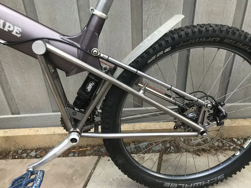

I braced both bosses using a brake booster. Fit the arm, then using longer bolts placed a booster over the top. Or it might have been the other way around
Found a pic, and as you can see also allowed somewhere else to ziptie the hose onto. I also was able to place a third mount at the top thanks to the stay wishbone boss, which i think gave it more than adequate support Dyna's%20sale%2020%2012%2009%20034%20(Large).jpg
