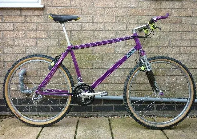

This is mine and i cant get enough of it.. its very rare and in original team purple from PACE, all purple Pace frames was team bikes am told by Adrian owner of Pace 8) mine is built as a replica around the original frame with my own spec in places like chainrings, cranks and stem in chrome 8)

Have you also considered that Paces required differently dished wheels? Not sure how critical that is - maybe one of the experts can tell us. It may mean that you have to have a seperate set of wheels.
