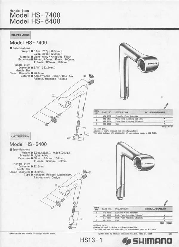

F fossala Retro Guru Apr 29, 2019 #1 Did the Dura ace hs-7400 stem come in a 25.4mm clamp size or just 26mm? I thought it did but velobase doesn't show any reference to it.
originalshinkicker rBotM Winner Apr 29, 2019 #2 If you look at the main spec it only shows 26.0mm but the small parts list, Item No 2, has a 25.4 & 26.0 push plate assembly part? Attachments dura-ace-hs-7400-stem.jpg 110.9 KB · Views: 278
F fossala Retro Guru Apr 30, 2019 #3 Thanks for the help. I guess the 25.4mm wedges are fairly rare, shame.
