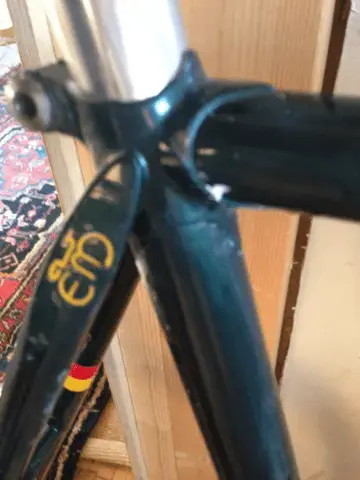

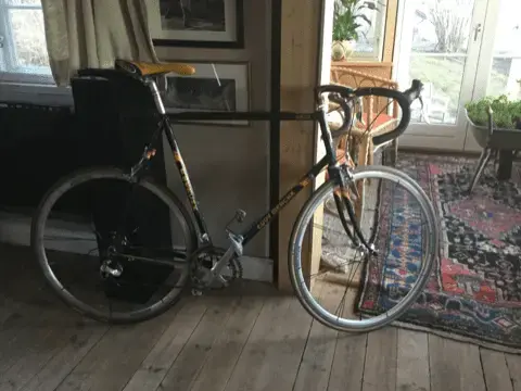

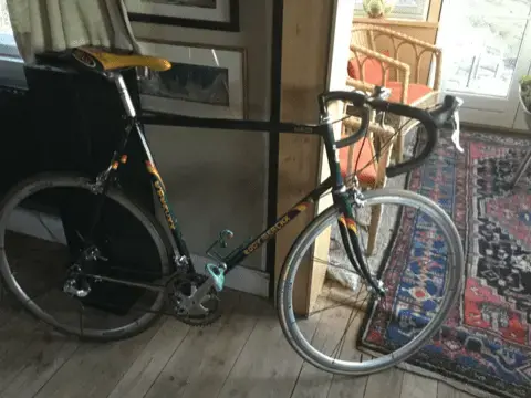

I Wonder if anyone could help me with a bike a just reacently pisket up:
- steel/frame material sl/SLX or something else?
- colour green yellow and red, accidentially?
- year of production
The rear brake attacment is straight not pointed as many of the EM-bikes. But i guess its a 95/96 Columbus SL.
The "group" is a bit younger than the frame, dura ace + Chorus brakes and stem bearings, cinelli bar, itm quill stem and elite cage. The wheels are wh-6500 - ultegra - kind of cool.

I can't really make out the numbers on your BB pic but this link will help you out there.
