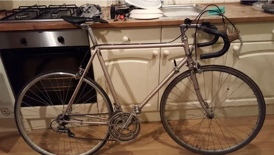

Hey,
New here, and I guess like most people I'm going to start by asking for information.
This is my new bike, (first proper vintage road bike), hopefully attached.
I believe it's a late 70's / early 80's Puch Mistral SLE.
Serial number is 6258974.
A lot of the components appear original;
- Suntour Chainset, (although rear derailleur is Shimano)
- Weinemann Brakeset,(although front caliper is Shimano)
- Neither wheel is original, although at least they're matching Weinemanns as well.
Can anyone help me identify the bike, or get hold of the original component spec's, (though I may not go back to fully original).
Dave

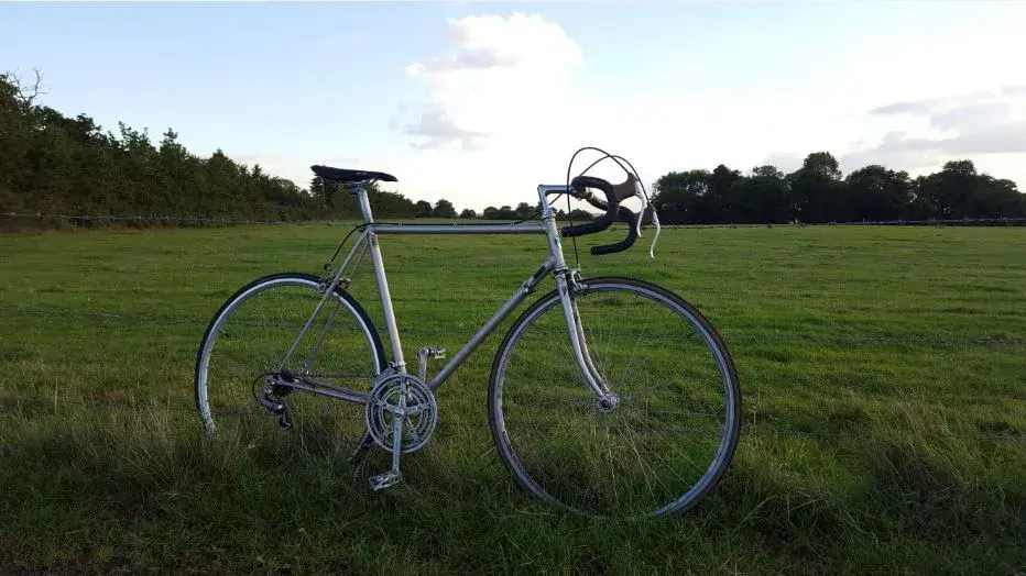

Decided to start working on the Puch, but first I repaired the rear puncture, pumped up the tyres, and went for a quick 'before' ride.
Not too bad, gears and brakes need some adjustment, (expected), and the old tyres definitely need replacing. Also, I don't like the original MKS pedals on it.

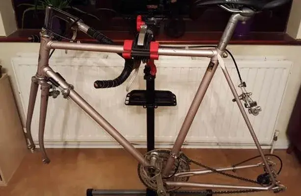

I've now started stripping the bike down and cleaning everything as I go along. Gear cables replaced, friction shifters tightened, and gears adjusted up - runs much better.
Wheels are now out for a clean and new tubes and tyres.

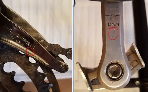

Last night I found some dating evidence - suggests late '77 or early '78.

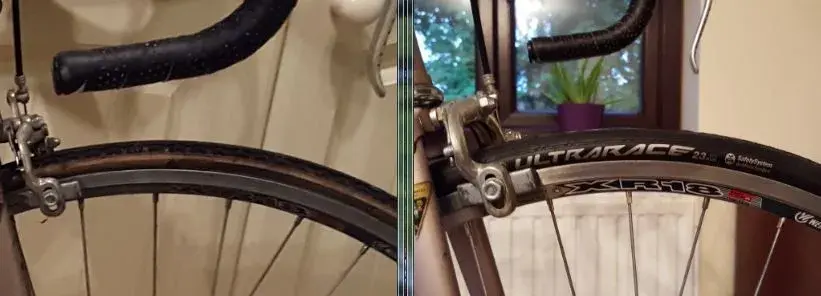

I used Gunk degreaser to wipe the wheels clean - very pleased with how well they came up, see before and after pic;

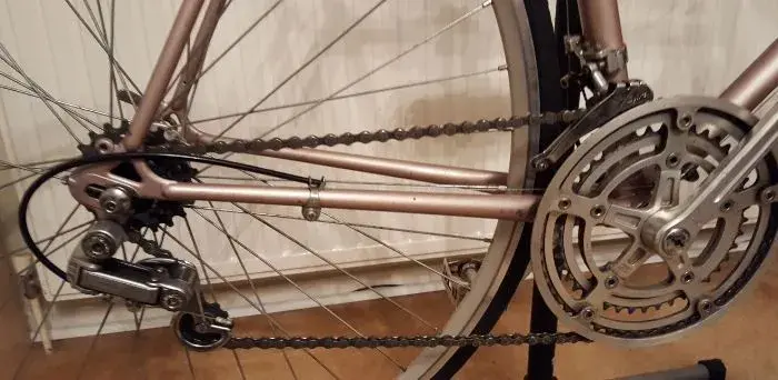

Chain, sprockets and derailleurs all cleaned and reassembled.
Toying with the idea of a new chain, but not really necessary at the moment as all is working well. New cables are in place too.
