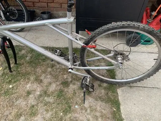

This morning when having a brief look at local selling sites this frame popped up- I was having it no matter what. Needless to say she wasn’t impressed when I came home with a boot full of bits and a frame lol.

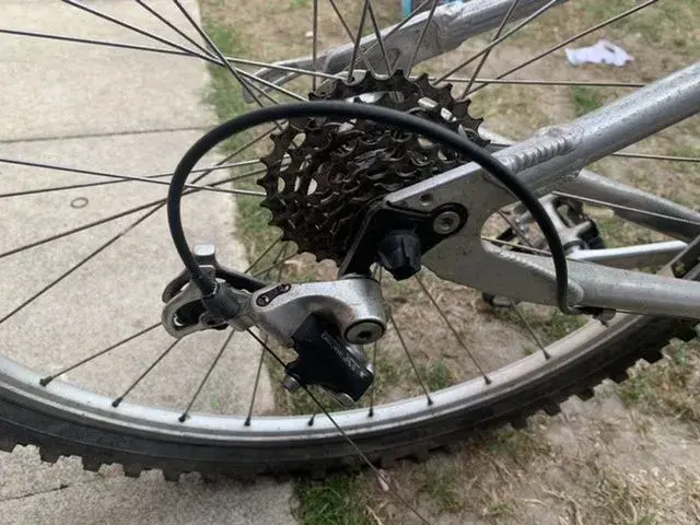

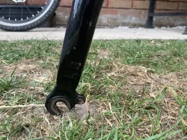

Advertised as a Pantera but it could be an avalanche, needs a good polish and I plan to put this back to period spec as it had the original gt forks, get it back to its former glory only to be riden lightly and stored safely. Specialized chainset will be going as will the Sachs gripshift.

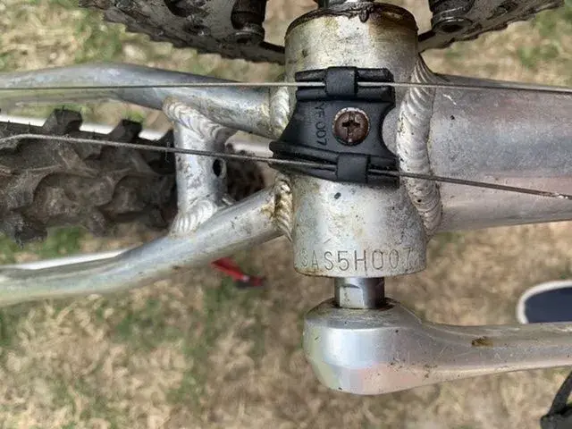

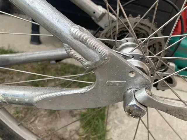

Few questions - am I right thinking it’s around 96?
What size headset are these?
Any ideas on how this can be identified as a Pantera / Avalanche?

94 to 97 -ish 7005 frame
Pantera had a flat end cap whereas yours has a curved one so more likely an Avalanche
1 1/8 headset
Mid to late 90's LX was good kit with plenty of modern spares available, later stuff seems to be easy to source and it is all compatible, even up to SLX 9spd.
The chainset is worth a few pennies to some.

I thought only the Zaskars had a flat end on the top tube?
I will be keeping it rigid. I’ve got suspension on my O2 so seeing as this has the original forks I’ll keep it as it is.

My bad, certainly the older ones did but you are right, the later post 1994 frames were curved.

I'm guessing 95 or 96. These years the frames were identical, with the only difference coming from the spec - the avalanche was slightly better. If the rear mech is the original one I'd guess at an avalanche.

LGF what forks are they please?
