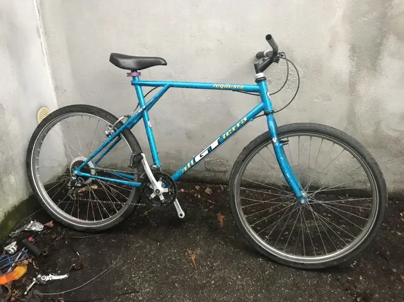

I picked up a GT tequesta the other day which I think is a 1993? It’s not in terrible nick but definitely needs some work. Plan is to build a budget commuter/tourer. But I’ll need help as I’m pretty useless with bikes.... :roll:
First off, some pictures....

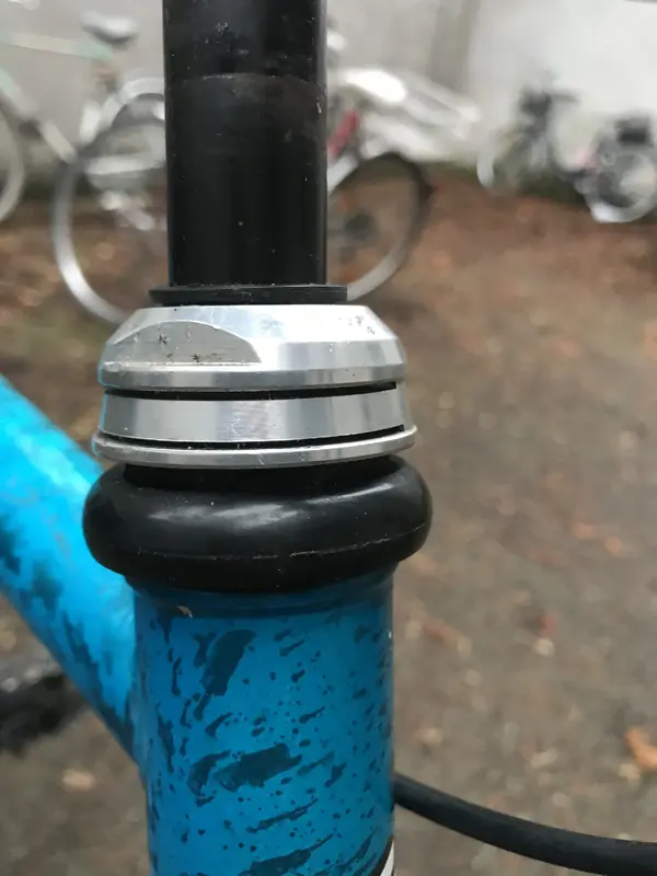

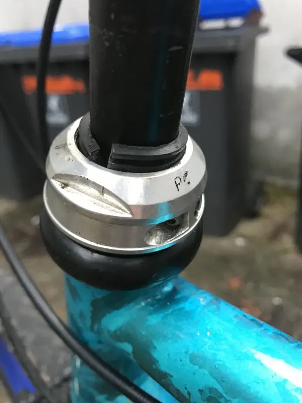

I can’t get the handlebars to stay in one place though. Am I right in thinking that the long Allen bolt through the steering tube does this? I’m new to pulling bikes apart. There’s a rubber ‘sleeve’ that sits between the steering tube and the handlebars where they slot into the tube which looks like some kind of spacer, doesn’t look right to me?

First of all, nice bike choice, looks to be 1993 year and the colour is nice.
And to the headset thingy. The Tequesta should have probably 1 1/8" headset size, in threaded version. It means the stem should have a diameter of 25,4mm (not sure now whether 25,2 or 25,4, doesn't matter). I guess someone tried using a narrower stem that should belong to a 1" headset, so that the stem is 22,2mm.
That's why it can't stay in place and the previous owner tried to make a "reduction" out of the rubber bit.
Maybe it is something else, but this looks quite likely to me. Measure the diameter of the stem, or put it out and remove the rubber thing. The headset could be redone, too, I think - there seem to be a bit too many spacers and things there. Also, if it is this case, you would need a 1 1/8" stem for threaded headset, which is not that common, but eventually you will find one.
Definitely don't ride it prior to checking this.

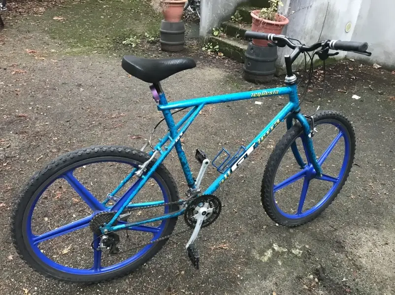

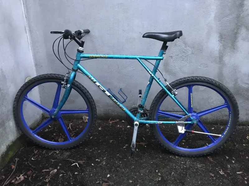

Bought a cheap scrap bike earlier for parts. Came with 2x Schwalbde Marathon plus tyres which was a result. Toying with the idea of fitting the mudguards too but not sure how it’ll look.
