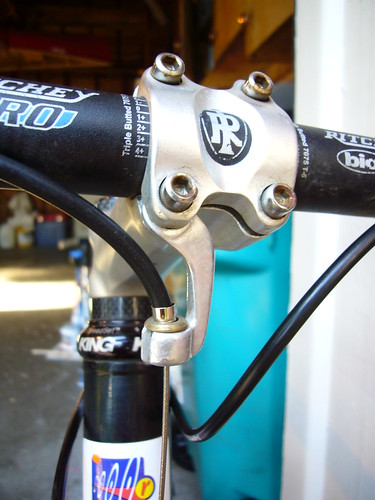

Am I being stupid here? It kinda seems like bad bike design. lol. Does anyone know of a possible solution to this problem? I thought about maybe attaching a cable hanger to my stem where the handlebar bolts on. Like this:

I think I may run into problems doing this though since the handlebar mount bolt may bottom out before the bar is tight.

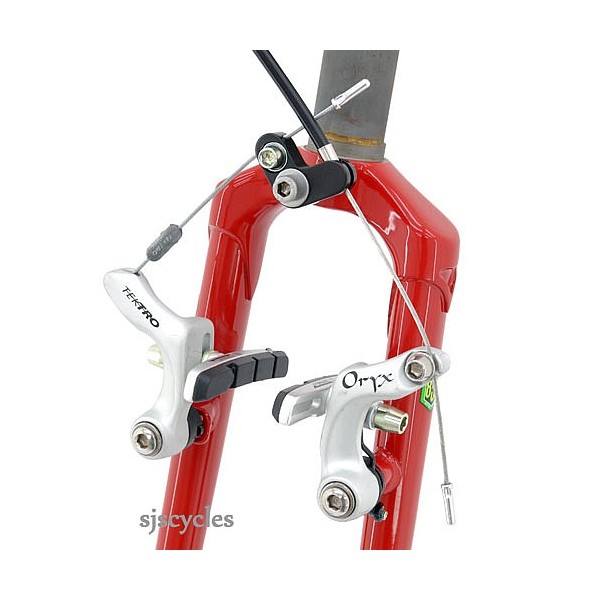

One option I thought of was a fork mount cable hanger, but I'm fairly certain this would still have the exact same issue.
Or maybe one of these? I think it would still rub badly though, but at least it would be outer on outer.
