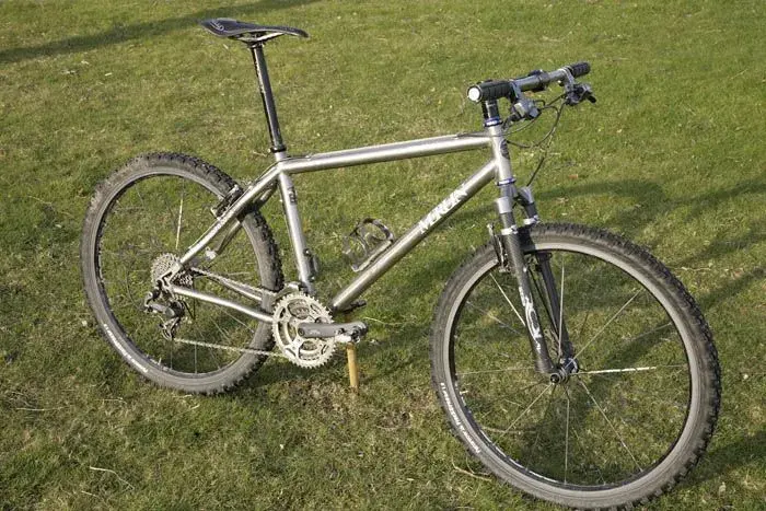

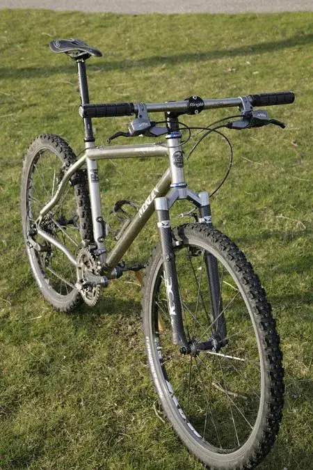

pics of 80mm frame with 420's on. Obviously all frames differ, but this is quite a similar shape to many a hei hei (18in)
Indeed. Looks OK to me.
