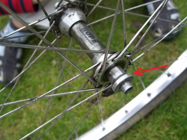

But early 90's say 1993* they brought out the Hope hub, it was Ti tube with angle chunky aluminium flanges and grub screw affixed spacers.
I assume it's this hub
Year calculated as it's mine, it was bought around then and the rim it's built up is Araya RM-395 Team, which is a 1993 only rim

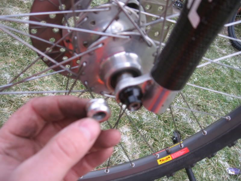

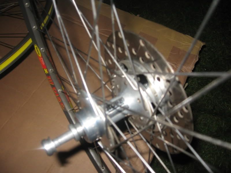

FluffyChicken":yp4jfkf1 said:
They gained disc brake compatibility at some point in the mainstream, no idea when or what different type, it's never interest me.
Actually, they built the hub in order to use their disc brake, the brake was developed first, see above.
Oh, and I have a bike built in 1992, which I believe is full original spec which came with one of the hubs as above.
Rod_Saetan":3k8iz907 said:
Ah by that I was meaning 'mainstream' disc brakes onto the Ti-Glide/Suspension hubs i.e. the splined interface to spider version.
Unless you mean they built the Ti tubed versions as splined/screw on first ?
