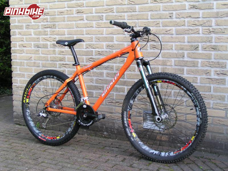

And because of the compatibility thing the used ones on ebay can be very good deals. pics:
above is the 29er
