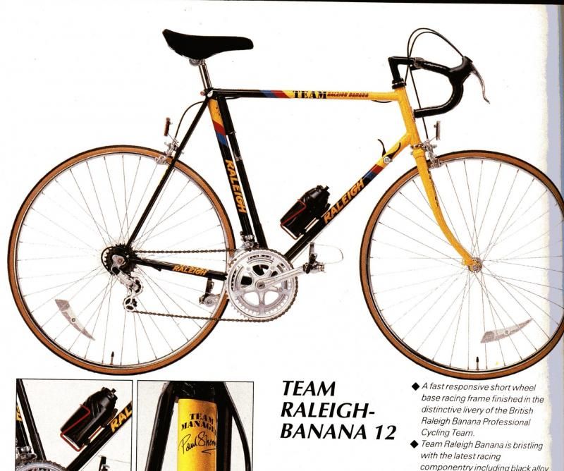

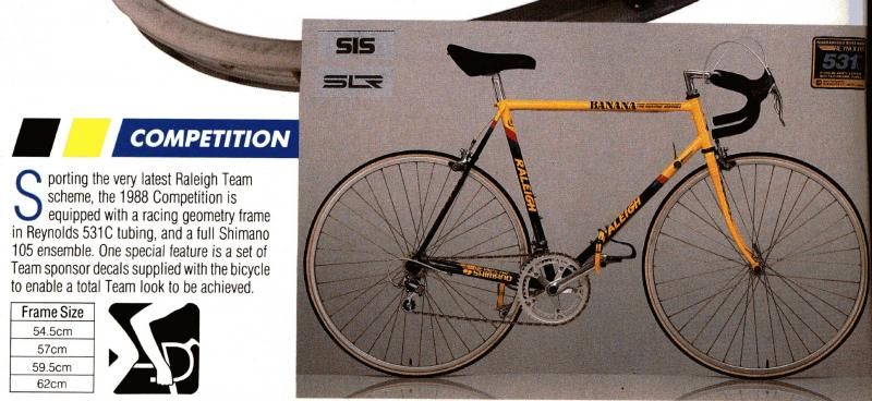

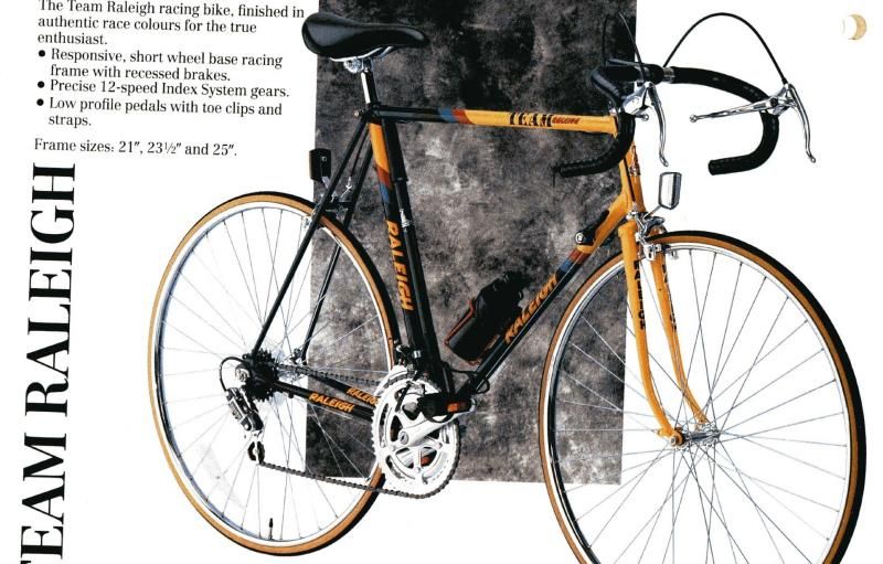

To avoid any confusion, and to the best of my knowledge there were 3 'catalogue' variants of this bike:
1) 1988 531c Team Competition:
2) 1988 18-23 Team Raleigh Banana 12:
3) 1990 Team Raleigh:
Points to note:
The 531c bike has a slightly different paint scheme to the 18-23 'gas pipe' bikes, in so much that the entire top tube and tops of the seat stays and seat post are yellow, as per the bike ridden by the Raleigh Banana Team of the day.
The 1990 bike lost it's 'Banana' decals and is simply called the Team Raleigh.
By that time the banana importers had switched allegiance to Falcon under the management of Keith Lambert. Not sure why Nottingham carried on turning out the colour scheme though, market demand or maybe an over-stock of part built machines? Just to confuse things even further, Falcon brought out a cheapish replica of their Team Banana bike around this time (don't think they did a posher 531 version though as the Brigg plant badged its better road bikes as Holdsworth at the time).

I've yet to see a 531c framed one with the Banana decal on it!
Maybe previous owners just couldn't live with the word banana on their bikes
Plus, the Team Competition came with team sponsor decals which you could choose to apply or not..
