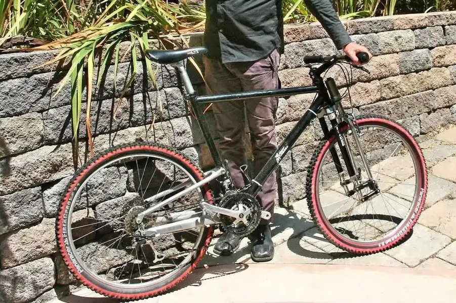

Hey Lewis, I helped Mert develop the Leader and I thought up the name, too. There is 2.5 inches or so of travel, the Risse shock is quite rebuildable-Risse is still in business here in NorCal. When it was new, it was one of the longest travel forks out there. If you notice, it has two Leading Links per side of different lengths. This makes the wheel travel up vertically, rather than through an arc, like a leading link fork with one link per side would do. The result of this is the amount of Trail never changes as the fork travels up and down. Regular forks with sliders change the amount of trail as they move up and down, with the result being shorter trail as they compress, and quicker steering. Thus you have the same steering feel throughout the range of travel with the Leader fork. Also, you'll notice the links are angled upwards at the front, which helps it go up easier-I used to demonstrate the fork by riding a bike with it fitted head-on into a curb and it would just pop up and over it with no problems, to the amazement of onlookers. Here is a pic. of the first Fisher RS-1 bike (designed by Mert) with the Leader Fork on it. The rear sus kinda looks like the fork. The legs in the shot are GF.

lewis1641":10sdiq8k said:
Fantastic info pat. Thank you.
Got to love this site!
Indeed you have. That's a great bit of info, thanks Pat. I bought a set of these a while back now in the hope that I got a bike that they would suit, and the shock shaft was corroded. I contacted Mert Lawwill via his website and to my surprise he got in touch and said he could replace the shock shaft if I sent him the fork. I obviously did this and he sent it back as good as new, along with a bag of bushings to keep it running.
Sadly I've yet to find the right build that these would suit, though I'm tempted to try them out on the DBR Ti once I've resolved the issues with the repairer. Do you think that these would work/suit?
I love the industrial look of them and hope they work well too. I don't plan to go off road crazy, but as long as they take the buzz out and don't ride like a clown car, I'll be well pleased.
I think you will be pleasantly surprised how well they actually work. Definitely much better than the early Mag 21 of the same vintage, with 60% more travel. I have The Mag 21 on my 1991 Funk, and it is a much harsher ride than the Leader.
