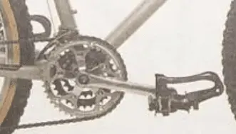

Take a lot to the suntour SR 350, they should be cheap and with some TA specialites are quite nice and weight not too much.
