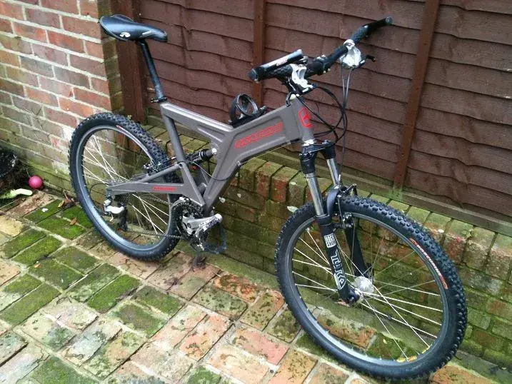

Lovely colour, did you spray it yourself? I could do with doing mine again at some point, do you mind letting me know what colour you used if you know?
Thanks
Simon.

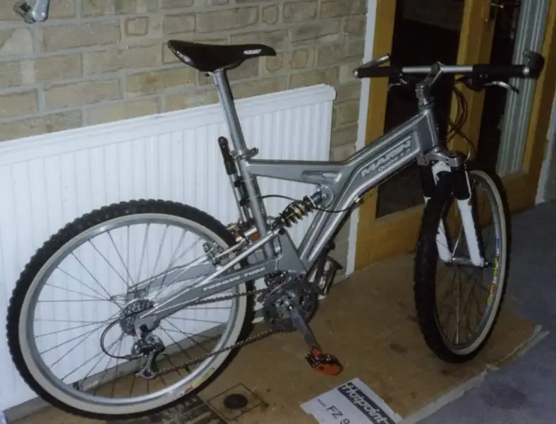

Also interesting to note that both yours and the one in the ebay have the bottle mounts on the top of the frame. I wonder if that indicates a difference, as I didn't think any of them had them. perhaps frame size? mine is a 17.5"
As you can see in the pic no bottle mounts.
Hi
I had the frame powder coated by a company local to me (near Southampton) It was about £50 as i remember...as for the colour its a kinda metallic-y browny grey which I really liked but proved to be a bit of a marmite colour!..."pub bike brown" was one description! As for the bottle cage mounts...mine also was a 19" like the ebay one...so perhaps a frame size thing?
