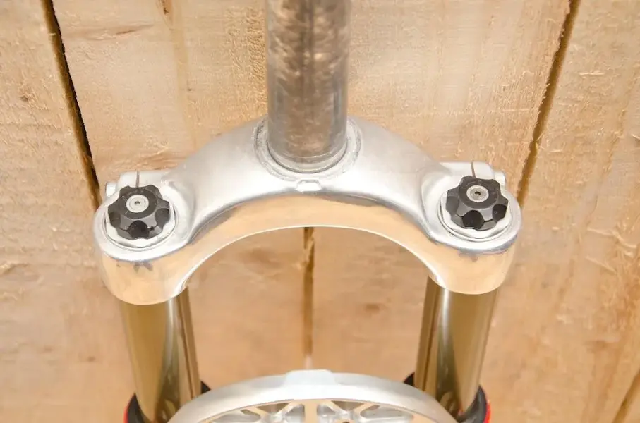

Early Z1's had 2 HSCV cartridges. 1 per side, can be identified by the perload knob & the flat blade slot for rebound control (See bottom pic). Later Z1's had 1 HSCV cart.
A Z3 should just have 2 preload knobs (See top pic), and maybe rebound control on the bottom of 1 leg.
The chassis are identical, but the internals aren't.
Not very difficult to swap Z1 internals into a Z3, essentially making it a Z1 aside from the decals.
The Z1's HSCV cart(s) is a higher quality damper than the rather simple orifice controlled damper on the Z3.
When riding the Z3 will be more prone to spiking on the trail. Whereas the Z1 can take hard fast hits in a much more controlled manner.
