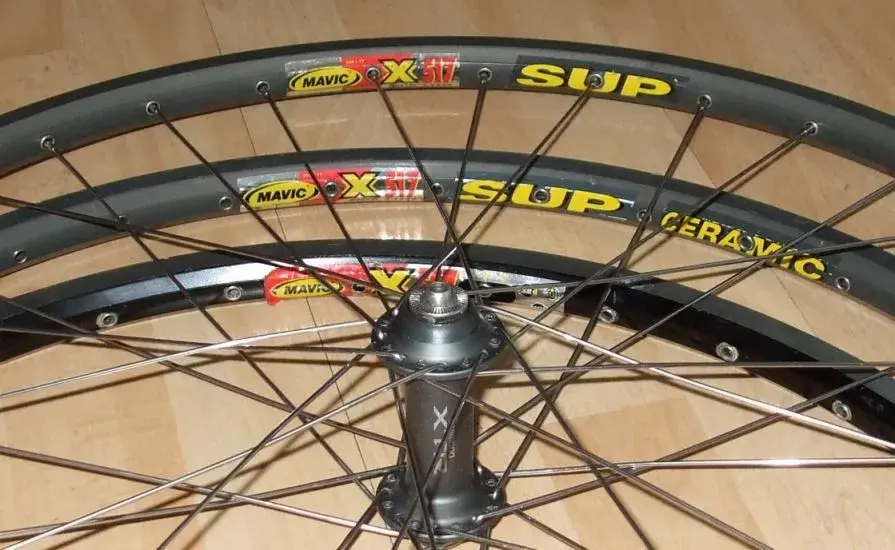

I think they made a variety of types over the years. These three that I have are an NOS CD on XTR hub, a CD Ceramic which again is the same colour (near enough) as XTR and a black 517 with anodised black surface, which I believe to be a black version of CD - but if anybody knows better, I'd be grateful to know.

Whats the difference between the CD and the CD Ceramic? Just different coatings. I assume mine is the CD.

This is mine:
It looks like CD from here. Both CDs have a rougher finish than a silver rim, but the CD Ceramic is rougher than the CD and far far tougher. So tough in fact that you use a much more caustic ceramic-specific pad with the ceramic rim. Those pads would wear out a standard rim in no time.
The benefit of the rough pad acting on the ceramic rim is not just long life, but also more powerful braking, particularly in wet/slimy conditions. BITD, a silver 517 was £26, a CD was £29 and a CD Ceramic was £55.
