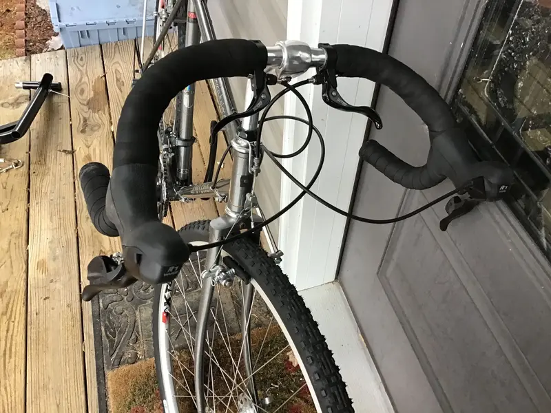

How about something like these? Their not Shimano so shifting is a slight tad sluggish, but they always work. Their Chinese from eBay. Cross brakes are a handy thing to add. They are on a 1970s Japanese Univega set up for road and gravel. It’s amazing how nice a modern cockpit is on a vintage road bike. When I was 74 I rode this bike 76 miles on gravel and another time 102 miles on the road. The nice thing is you have so many hand positions that your wrists stay pain free. The bar tape is thick two sided sponge weather seal tape that is compressed by the foam bar tape. I love it, no wrist pain. D751B93B-BD6E-41AF-94B6-63BD4F97F846.jpeg

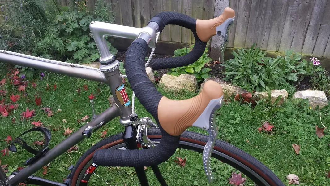

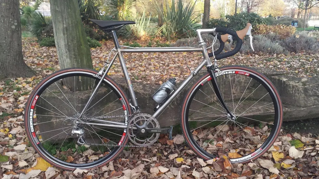

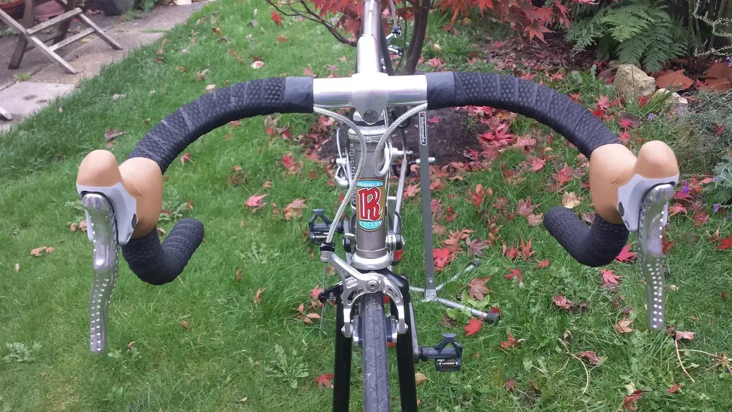

Hi, i have theTRP levers on my Ribble as I wanted run indexed downtube shifters with modern brake levers that were comfortable for long stints riding on the hoods. Not only are they really comfy and light to use on the hoods they look pretty cool and retro with most of the grey plastic body covered by the tan hoods. Also they have a neat spring loaded quick release button. I think there's other colours and non drilled versions available as well.

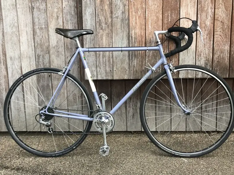

Bike in question pic below.
