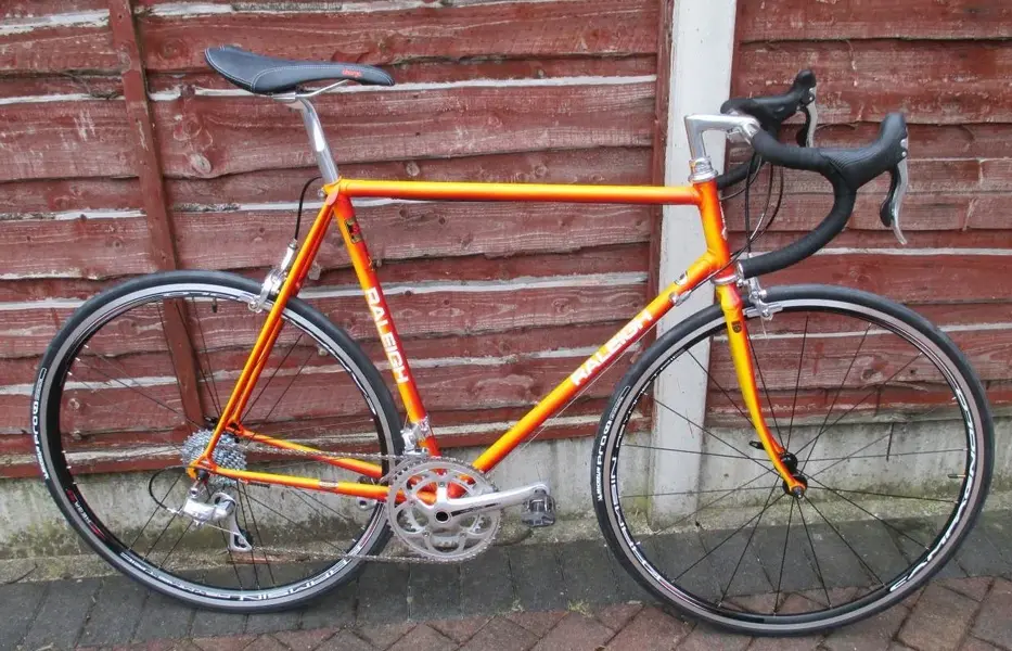

Never miss an opportunity to post my current ride, 1986 frame with all 2014 components :D
That bedraggled is exactly the sort of build I suggest, although my personal taste would be to go for some conventional wheels to avoid an 'alloys on an E-Type' look. The modern UT alloy chainset looks absolutely fine - unlike the Shimano Power Rangers look.
