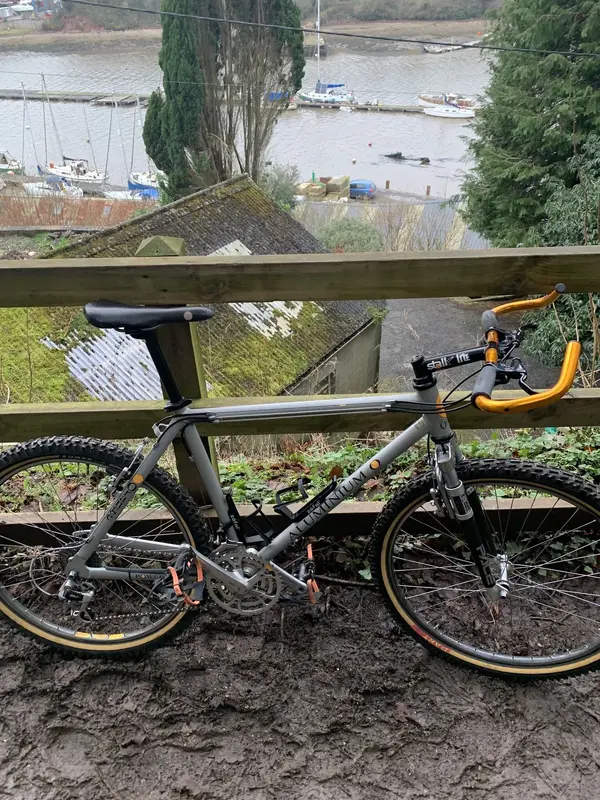

I'm looking to source an Aluminium O for a good mate/work colleague.Very well travelled,groundbreaking pioneer in the whelking industry (true!πŸ˜‚),general legend.He had one back then but was stolen.Currently on a Whyte E-something (not electric) but is missing the ride/geometry of the 90's.Would love to find/build a good one for him.Will be a rider.
I need help to identify the right bike before I try to source one.He said it was a '94 but of course as we all know memory can easily slip a year or two.Checked archives but couldn't find what I needed there.
His had Pace forks and was a grey colour,not polished.He sent a couple of pictures,reckons it was like these;

Have to say this model,with this finish,kind of passed me by.Saw very few Oranges round here.I do really like it.Love those stays and the cable guides are a nice touch.

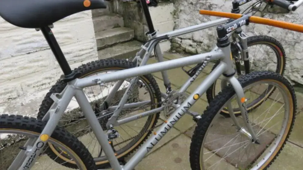

Back on topic. The Aluminium "O" was in the Orange model line-up from 1991 - 93.
It could be possible your mate bought it in 94 if a shop had unsold stock.
The 1st and 2nd Gen models (1991) had down tube routed cable guides and the rear brake via the top tube. The rear mech hanger is non replaceable.
1st Gen serial numbers start A9102xxxx
2nd Gen serial numbers start A106xxxx
For the 1992 model year, The Aluminium "O" had revised features such as 1/2 " shorter chainstays, all 3 cables were top tube routed and a replaceable mech hanger.
3rd Gen serial numbers start A108xxxx
4th Gen serial numbers start A112xxxx. These are identified due to lack of chainstay bridge.

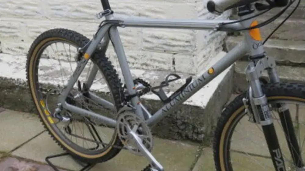

Early models were orange/white fade or the Matt Silver pictured. Those are Cheshire1980 and clockworkdavo's O's btw.
Gen 2 added Satin Black to the colours.
These colours continued with Gen 3&4 but with revised graphics. Anodised Purple was also added in 93...most likely to clear the remaining frames. The Aluminium Elite appeared alongside the "O" as the superior model in 1992.
The "O" was dropped from the range in 93 and the Elite eventually evolved into the E- series evolutions.

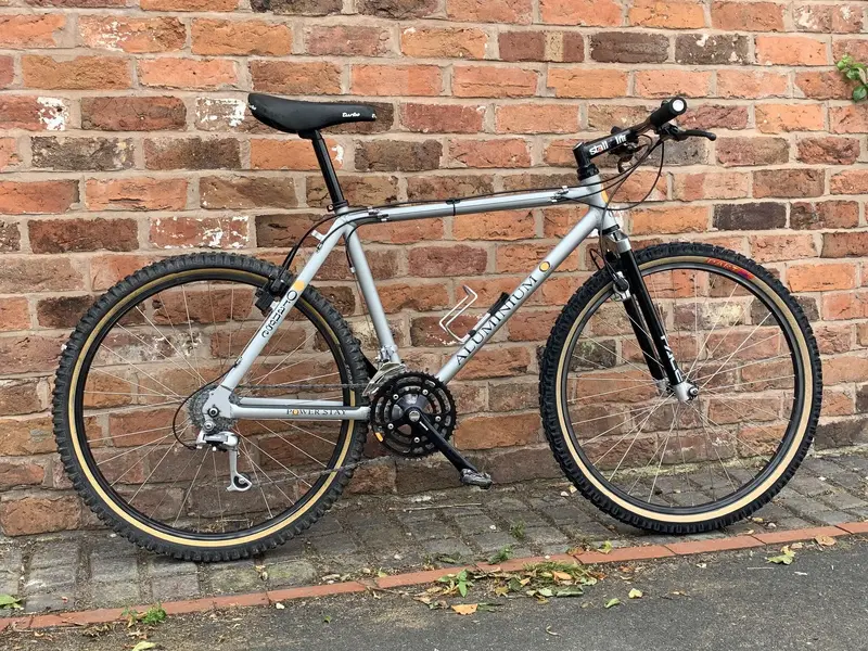

If that's Callum's 19" O - then that probably used to be my frame from BITD - I now have a 17" and much prefer the fit.

Still got the Aluminium O pictured with the pace forks. Its my main MTB rider still. The other O pictured I sold to Davo, which i originally bought off Carge.
My O's linked in my sig if you can see it, I no longer have it but the frame may be around here somewhere. I could ask.
It's 19" and at a tad under 5'10" myself I can't ride the smaller frame.
19" seems right.
