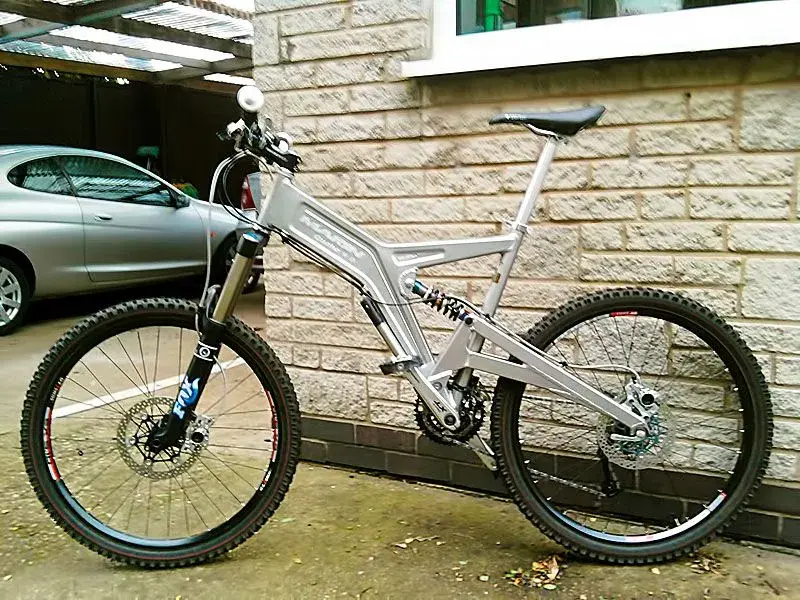

I have a Quake 9, I had to get the Pivot point re welded due to cracking and I replaced the rear swing arm with a B17 unit.
It is not anodised, it is a very hard to remove paint, but it is paint. I didn't bother to match the paint on the frame as it was quite a small section, that is mostly hidden in use anyway. I did however try to get the paint matched for the swing arm unfortunately the local place I used could not quite do it. I ended up using a silver from the ranger Rover range of colours.
I doesn't quite match but it's not bad. Hopefully you can see in this pic?

Have to say, your bike is awesome. Thats what I'm aspiring to. How did you put the rear disc brake on?
Hi
Thanks, The Swing arm is from a Marin B-17 it comes with disk mounts, however it needs a bit of fettling to get it to fit properly. you could also use a swing arm from a newer Mount Vision. The B-17 is ideal however, as it is a bit longer, so it gives a small amount of extra travel. But also increases the head angle, which is good for the 6" forks. You should probably not go for such long forks, unless you like relaxed handling. ;-)
