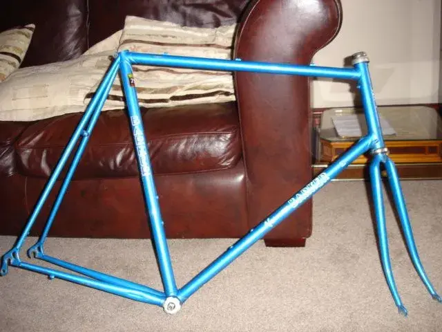

I have aquired this frame from the original owner.He says its a 753 peugeot (he forgot which model),but had it refinished by Vernon Barker.I would like to put back to original model/colour scheme. Frame no Y8128217 and has 74 in larger numbers under the bottom/b.
Any peugeot experts out there?

What does the 74 stand for under bb,obviously as you say proably 86 to 90 model.
isnt that just the length of the bracket?
The weight might indicate if its a 753 or 531 reynolds frame...
( 753 - Heat-Treated Manganese-Molybdenum. The most exclusive tube set from Reynolds. Essentially 531 made with reduced wall thickness and heat treated to increase tensile strength)
Peugeot Bicycles built during the 80's have a serial number with eight digits and a letter prefix.. like yours.. first number after the letter indicates the year.. so its a 1988 model
serial no
According to this built in Dec 88

Shape of the cutout bit of the rear dropout definitely looks like those in '89 catalogue. '88 753 Perthus Pro has more of a triangular shape. I've got a '90 653 Athena with the same shape dropout but the brake cable guides got moved to under the top tube that year so '89 does look likely. Are you sure its a 753 frame? Take a look here (page 7) it could be an '89 653 Racing Team MAB Z. http://cyclespeugeot.com/PDFs/1989French.pdf
Didn't the OP have SEVEN digits and a letter prefix? I'm in a similar position trying to date a renovated 531 frame with the number Y8090814. Am clutching at straws hoping that 7 digits = 1978 and 8 = 1988 frame.
