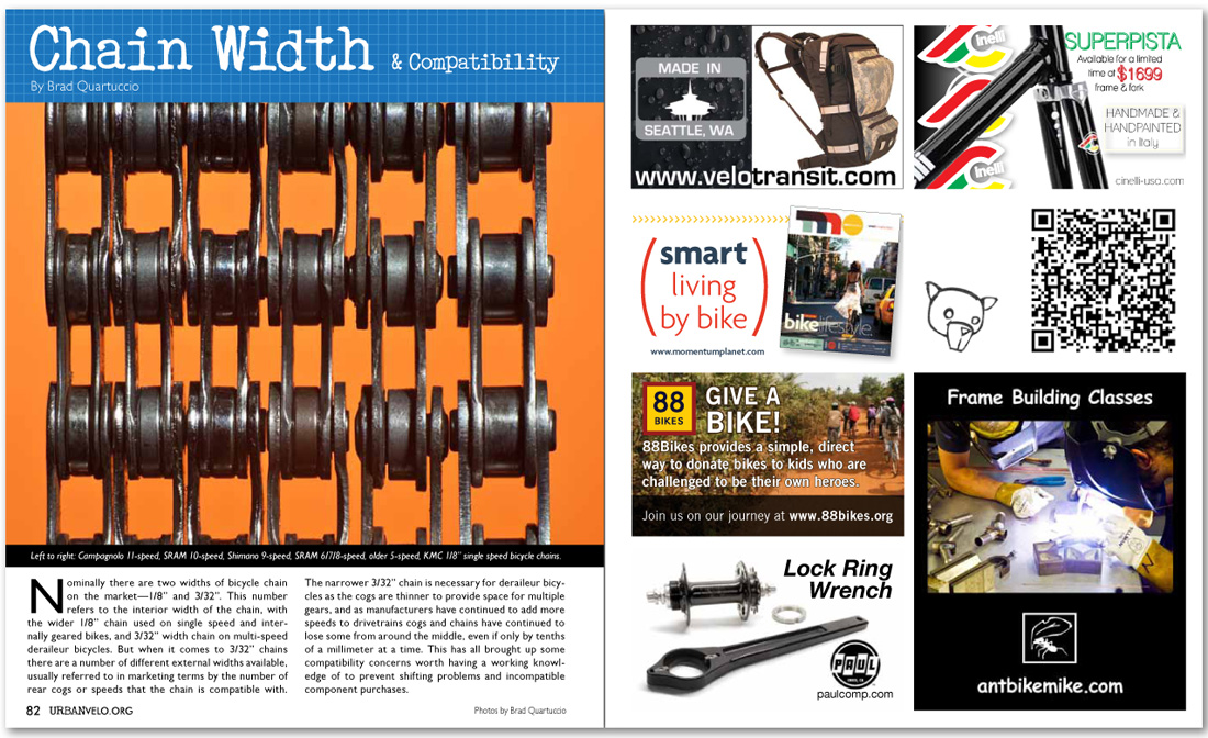

It sounds like your chain is pooped and has stretched. All chains are the same measurement between links as the bleow pic shows..
You can run 8spd chains inside 9spd mechs quite happily, I'm running 9spd Ultegra with an 8spd and theres no clearance issues. same with a M570 LX mech on another bike. I've been running 9spd in 7/8spd systems for years as sometimes 9spd chains have been cheaper than 8.
Chains are the same distance between when new.
