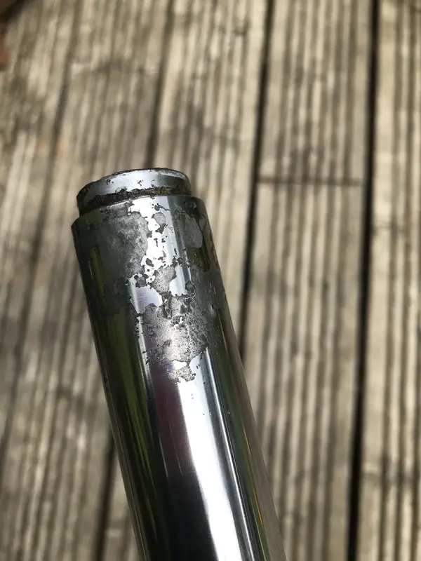

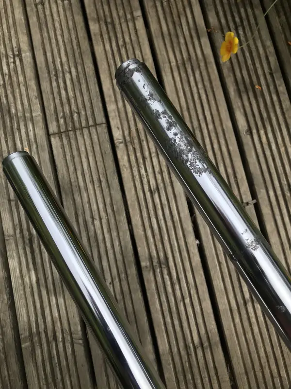

Oh lord, took my Manitou 1’s apart today and the stanchions are properly pitted.
I’m on the look out for some spare ones but if that doesn’t happen, has anyone had any luck rechroming fork stanchions?
I’ve looked into motorbike fork renovation and it consists of measuring the existing diameter, grinding the chrome off then replating to the original diameter.
Prices look a little silly though (£150-£180 for motorbike forks) but wondering if anyone has any experience or recommendations for mtb forks?

OR... do you need to.
The horror show that you have, from what I can see, is near the lower bush. This part of the stanchion they even machined away on later forks to save weight. Whilst the region of that bottom bush looks bad, so long as the bush locakes, and the bore of the slider isn't shot, then you're half way there.
The top bush area by the seal, this doesn't usually get the corrosion as a wiper runs over it all the time (but it does wear if any grit gets in the mix. Examine the land where the seal slides, and you *may* be ok...
But, but… I’ll know. 🥺
Actually, you may have a strong point there. I’ll go and have a stare at it and see if there is any pitting around the top seals / bushings.
I guess I just need to commit to “it’s just a looker” or “it’s totally for riding” as my guiding star. One is much cheaper. 😏
