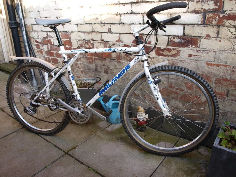

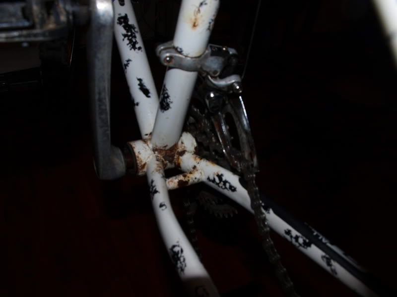

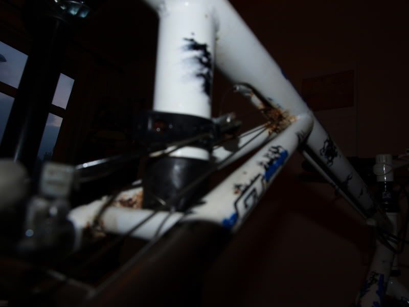

Fast forward and I have hoarded a 1992 groove tube Avalanche that's been neglected and showing rust. What to do? Easiest is a blast and powdercoat and decal, harder is recreating a GT legend paint.... :| I'm not super keen on the 92 anyway though it would be easy to do, cow print achieved by lack paint sponged on. The 1991 zebra was nicer though. Hmm so what to do? Any wisdom, tips or ideas? I'm feeling nostalgic and that can only mean dragging this project out (as soon as the others are done)!

Other easy options are a bravado yellow or even better I saw someone here with a flipped bravado, blue with yellow decals so blue with white decals is an option...

The black splodges on the 92 Avalanche and the purple/blue ones on the 92 Team Avalanche would have been applied with a sponge. Pretty easy to do I reckon.
The thin black lines/stripes are dribbled on using a fine nozzle. The paint probably would have been warmed up to make it thinner and less viscous.
The white dots look to be drops of paint thinner splattered on while the colour coat was still wet, revealing the white base coat.
Of course all this would have been done by hand and each paint scheme is unique in that respect.
