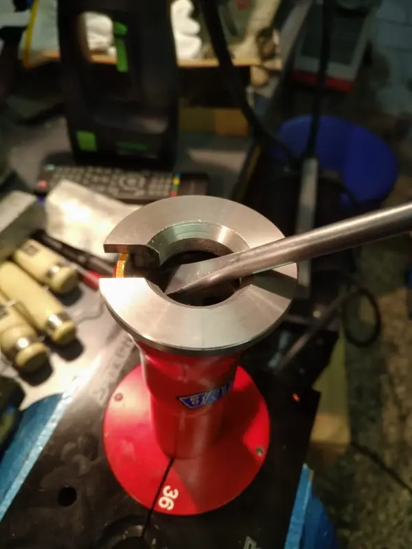

This is the tool to take the oil seal out, it's called 'slider protector'. The picture shows my own reproduced tool.

A good cheap version of the stancion protector is to use a lamp shade reducer - it does exactly the same job as the marzocchi one and will cost you all of a quid!
