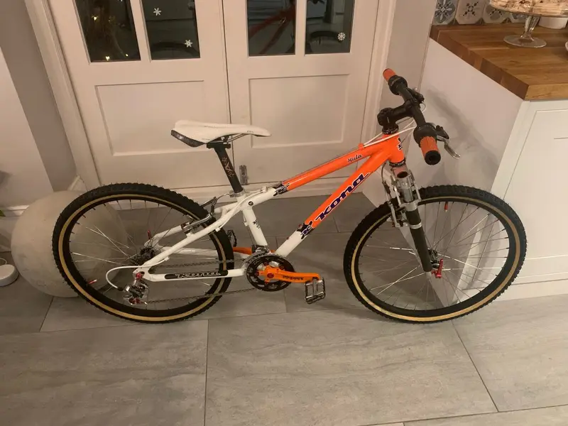

Has he been out on it yet? My daughter would love that when she's bigger, she's on 20" wheels at the moment. It's all about the orange for her!

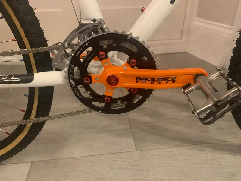

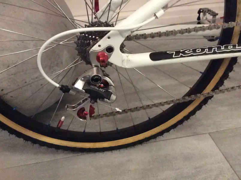

Went out for a short spin yesterday. He likes it! Needs a couple of mods though. Brake levers need reach adjusting beyond limit - sorted that now - and he struggled with the shifters. The internal spring needs ‘softening’ somehow.. I’ll have a play around with them and see what I can do.
Full Spec:
Frame: Kona Hula 12” Alloy
Forks: Pace RC35 MXCD
Headset: Chris King
Stem: Bontrager
Bars: Syncros Carbon
Seatpost: Exotic Carbon
Saddle: San Marco Titanium
Brake Levers: XT M739
Brakes: XT M739
Shifters: SRAM Plasma
Front Mech: XT M739
Rear Mech: XT M737
Cranks: Race Face Turbine LP 145mm
Rings: Race Face 32/42
BB: Control Tech Titanium
Front Hub: Hope Titanium
Rear Hub: Hope Ti-Glide Titanium
Rims: unbranded Alloy 24”
Tyres: Tioga Comp III 24” x 1.75”
Cassette: Ultegra 11-27
Skewers: Hope Titanium
Pedals: Exus
Weight: original spec was around 13.5kg and the plan was to reduce the weight as much as possible with components I had in stock (read: hoarded for decades). Managed to get it down to 9.5kg
